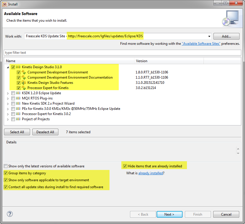

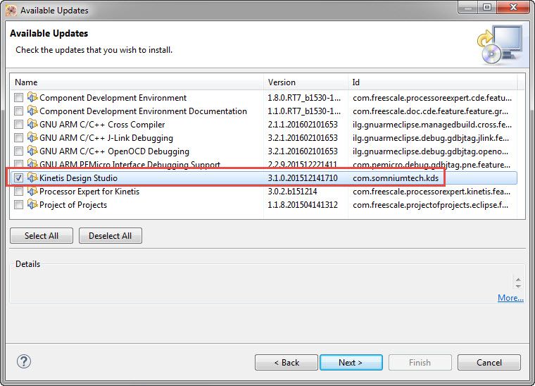

Online Update

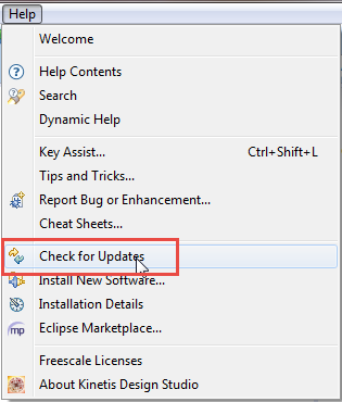

To install the update from the Eclipse update site, the preferred method is to use the menu
Help > Check for Updates
As this lists many other updates which might cause conflicts, make sure you only select the Kinetis Design Studio 3.1.0 update:
Install the update, then in a second update you can install the other KDS updates. Here again, do not select other 3rd party updates as this might cause conflicts:
Then go through the installation process.
An alternative method is to use
Help > Install New Software
and use the following Eclipse Update site:

Then select "Kinetis Design Studio 3.1.0" update from the list (shown for Windows host below):

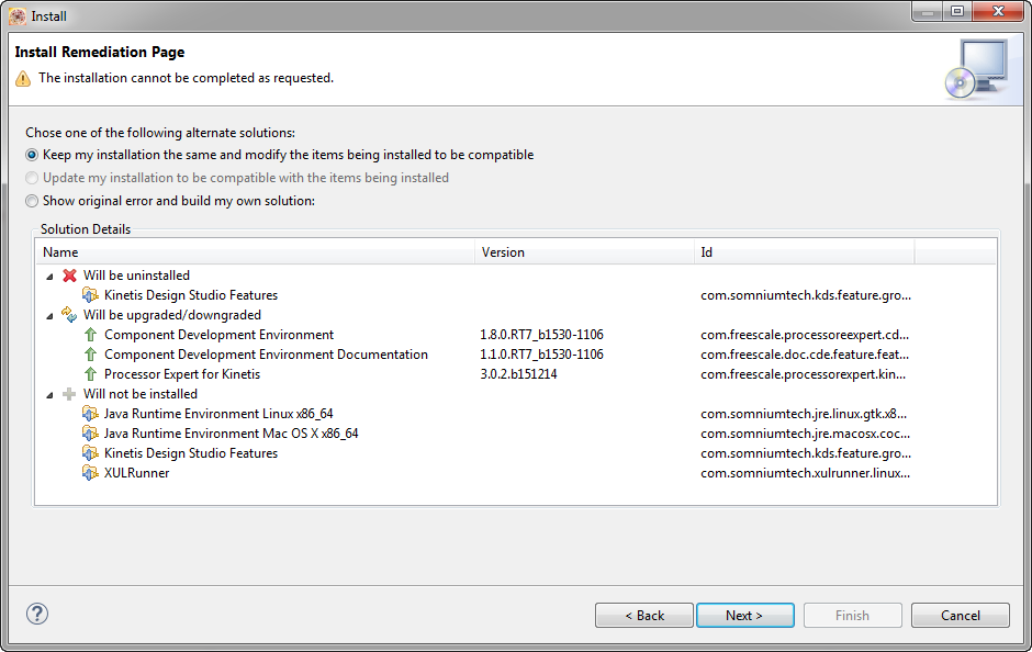

Next it will inform about the actions taken. A Somnium portion of the IDE will be removed and replaced:
Press 'Next' and go through the update process.

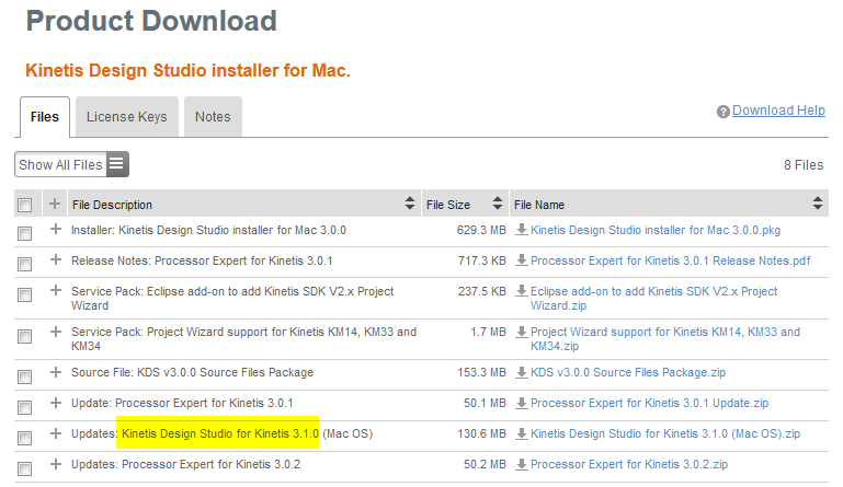

The update is available as zip archive which can be downloaded once and then used for an offline installation, pointing to the zip archive as update site.

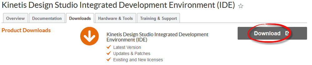

Go to Kinetis Design Studio Integrated Development |NXP  and click 'Download' in the Download tab:
Select the KDS 3.0.0 for the host you are using:
Select the "Kinetis Design Studio 3.1.0" update (screenshot shown for Mac OS X) and download it:

After few trials of installing the software, I would like to see the correct version being installed (V3.1.0). But I cannot find it anywhere. I can only see V3.0.0 in following screens. Could you please tell where I can find that. Thanks.
It should show something like this:
Erich
Thanks, Erich
Now I had this error message when I try to update the software:
What could cause this problem? I have updated the Java as well.
I tried to use either "Check for the Updates" or "Install New Software...". Both come with same error messages.
Thanks again.
Can you try with the check box 'contact all update sites' (bottom of the installation dialog) enabled or disabled, if this makes a difference?
Sometimes if update sites respond slowly, things might fail during install.
The other option is: you can download the installation package from the download page from www.nxp.com/kds:
And then make the update from this archive file, after unpacking it.
I hope this helps,
Erich

"Note: the updates are available for offline installation as well from the download section on www.nxp.com/kds"

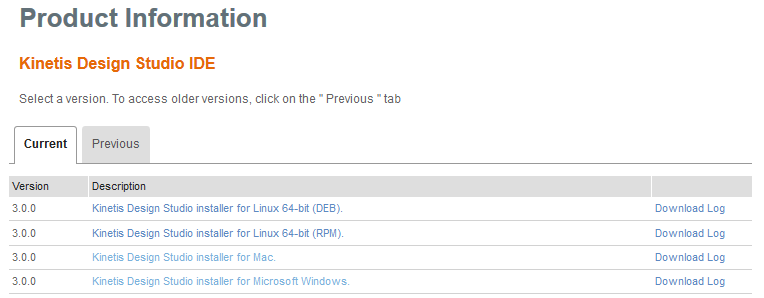

I see nothing at that site that is newer than 3.0.1. :-(
Hi Bob,
As it is an update, it is under 3.0.0.
Select downloads:
Then Download again:
(you have to logged in to see this):
Select the platform you are using, e.g. Windows:
Accept the license agreement, than have all the files and update for it:
I hope this helps,
Erich
PS: yes, I agree it is not the most logical way. But that's what is imposed by that web system.
How very intuitive that I should spend my time clicking a link that says 3.0.0 to get 3.1. :-(
Thank you for pointing that out.

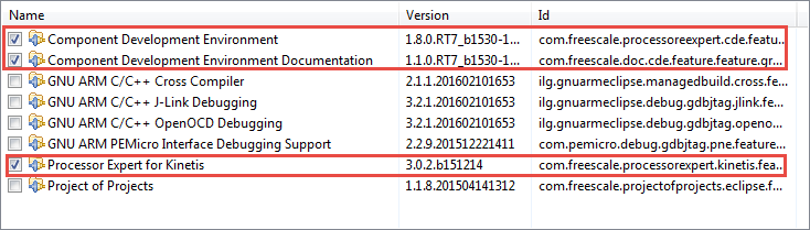

Detlef, it seems you have selected "KSDK 1.2.0 Eclipse Update" check box at the first screen. This update is incremental and can be installed only if you have KSDK 1.2 Eclipse Update already installed.
The recommended instruction for installation KDS3.1 update is using "Check For Updates" (command main menu - Help - Check For Updates). This will install only SW applicable to your KDS.
On clean KDS3.0 installation you will see the following items being updated:Capture.PNG
Regards,Marek
