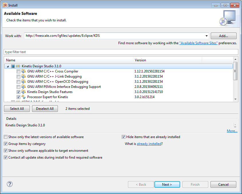

Online Update

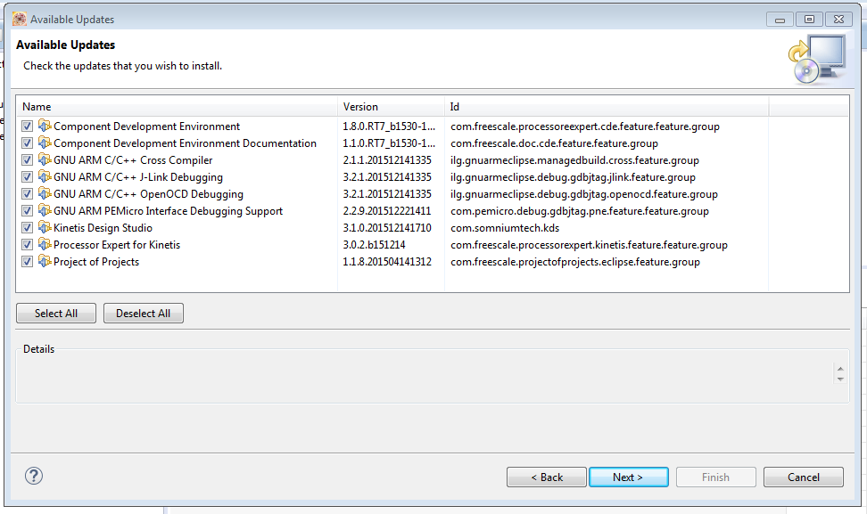

To install the update from the Eclipse update site, the preferred method is to use the menu
Help > Check for Updates
As this lists many other updates which might cause conflicts, make sure you only select the Kinetis Design Studio 3.1.0 update:
Install the update, then in a second update you can install the other KDS updates. Here again, do not select other 3rd party updates as this might cause conflicts:
Then go through the installation process.

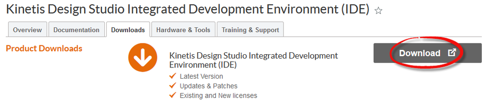

Go to Kinetis Design Studio Integrated Development |NXP  and click 'Download' in the Download tab:
Select the KDS 3.0.0 for the host you are using:
Select the "Kinetis Design Studio 3.1.0" update (screenshot shown for Mac OS X) and download it:

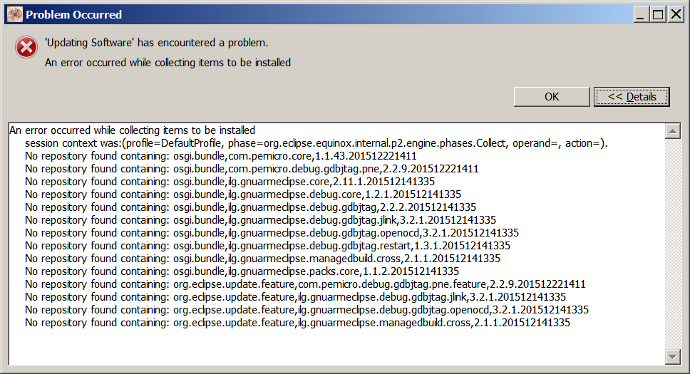

Now I had this error message when I try to update the software:
What could cause this problem? I have updated the Java as well.
I tried to use either "Check for the Updates" or "Install New Software...". Both come with same error messages.
Thanks again.
Can you try with the check box 'contact all update sites' (bottom of the installation dialog) enabled or disabled, if this makes a difference?
Sometimes if update sites respond slowly, things might fail during install.
The other option is: you can download the installation package from the download page from www.nxp.com/kds:
And then make the update from this archive file, after unpacking it.
I hope this helps,
Erich
Hi, Erich
I have tried to enable and disable the 'contact all update sites' and both have same error. I tried to install them from the downloaded file and it came with the same error, although I disabled the 'contact all update sites'. Two machines have been tested with the same error results. I am not sure is that caused by our firewall or antivirus software.
It looks other users are happy with the new version and the problem may on my site.
Thanks again.

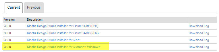

"Note: the updates are available for offline installation as well from the download section on www.nxp.com/kds"
I see nothing at that site that is newer than 3.0.1. :-(
Hi Bob,
As it is an update, it is under 3.0.0.
Select downloads:
Then Download again:
(you have to logged in to see this):
Select the platform you are using, e.g. Windows:
Accept the license agreement, than have all the files and update for it:
I hope this helps,
Erich
PS: yes, I agree it is not the most logical way. But that's what is imposed by that web system.
How very intuitive that I should spend my time clicking a link that says 3.0.0 to get 3.1. :-(
Thank you for pointing that out.

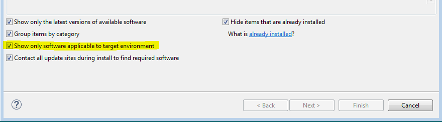

I can't for the life of me update my KDS installation (W7x64) :smileysad: Any suggestions how to deal w/ the error ?
Full "Details" text:
Your original request has been modified.
  "GNU ARM C/C++ J-Link Debugging" will be ignored because a newer version is already installed.
  "GNU ARM C/C++ OpenOCD Debugging" will be ignored because a newer version is already installed.
  "Processor Expert for Kinetis" is already installed, so an update will be performed instead.
  "GNU ARM C/C++ Cross Compiler" will be ignored because a newer version is already installed.
  "GNU ARM PEMicro Interface Debugging Support" will be ignored because a newer version is already installed.
  "Kinetis Design Studio Features" is already installed, so an update will be performed instead.
Cannot complete the install because some dependencies are not satisfiable
  com.somniumtech.jre.macosx.cocoa.x86_64.feature.group [1.7.0.76] cannot be installed in this environment because its filter is not applicable.
It seems you are installing Linux update to Mac machine. Select option "Show only applicable SW" before you select what to install - see attached screenshot.

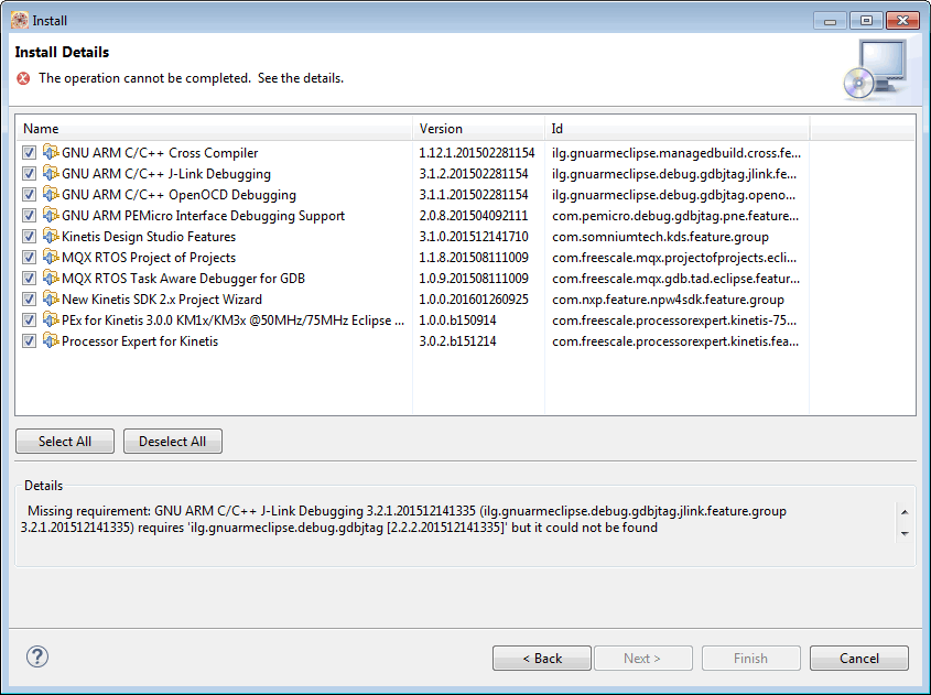

Thank you for the answer. Interestingly my KDS installation is on Windows 7... I did try your suggestion w/o luck unfortunately, the details message is now:
Cannot complete the install because one or more required items could not be found.
  Software currently installed: GNU ARM C/C++ J-Link Debugging 3.2.1.201512141335 (ilg.gnuarmeclipse.debug.gdbjtag.jlink.feature.group 3.2.1.201512141335)
  Missing requirement: GNU ARM C/C++ J-Link Debugging 3.2.1.201512141335 (ilg.gnuarmeclipse.debug.gdbjtag.jlink.feature.group 3.2.1.201512141335) requires 'ilg.gnuarmeclipse.debug.gdbjtag [2.2.2.201512141335]' but it could not be found
Hi Detlef,
it seems that you are trying to install as well other items (like the GNU ARM plugins). I recommend that you have a look at the screenshots at the beginning of the article and only install 3.1.0.
I hope this helps,
Erich

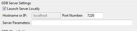

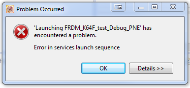

I have two projects in two KDS instances running while debugging both sides of a SPI m2m interface.
With 3.0.0, I selected a different OpenSDA device in the "Port" field, and then set the "Port number"s in each to different numbers.
("Debug Configurations" -> "GDB Server Settings" -> "Port number") .
After I updated to 3.1.0, the "Port Number" field is no longer available, and I cannot run both anymore.
Either session can be started first, but fail when started second.
Just as a check, I also tried two projects in the same session: same problem.
Any suggestions on another way to debug two projects?
Steve
Hi Steve,
it look to me that you not only have updated KDS to v3.1.0, but as well you have done an update of the P&E plugin?
The same happened to me too, and currently I'm only able to debug multiple boards using multiple ports with Segger J-Link (see Debug Multiple Boards with GDB at the Same Time | MCU on Eclipse ). Maybe that would be an option for you too (if you have an J-Link, of simply use the J-Link firmware on your FRDM-K64F (Segger J-Link Firmware for OpenSDAv2 | MCU on Eclipse )).
I have reported the issue to P&E and they wanted to address this in one of their next updates.
I hope this helps,
Erich
Hey Erich,
Thanks! Looks like you're correct. That one snuck in on me.
I currently have "GNU ARM PEMicro Interface Debugging Support" 2.2.9.201512221411.
Before the 3.1.0 and KSDK 2.0 update flurry I had 2.2.5.201511061812.
In eclipse, is there any easy way to unwind to the earlier version??
If not, I'll have to switch like you did until P&E fixes their issue.
Thanks again,
Steve
Thanks for the verification.
I uninstalled "GNU ARM PEMicro Interface Debugging Support 2.2.9.201512221411"
and installed from an older "com.pemicro.debug.gdbjtag.pne.updatesite-v2.1.0.zip".
I'm back up and running!
Thanks again,
Steve

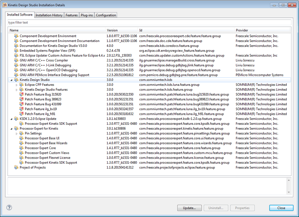

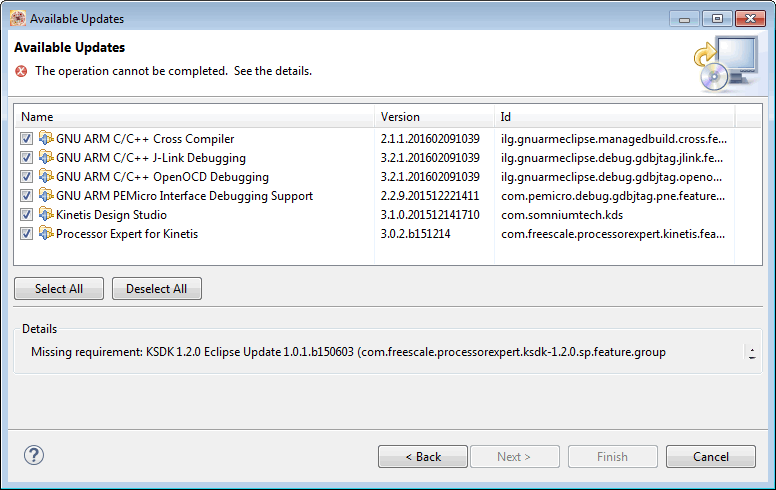

Hi Erich,
Thanks for your answer. The GNU plugins seem to be part of the 3.1.0 update, I tried deselecting them:
The whole list:
Unfortunately it didn't help much:
Details:

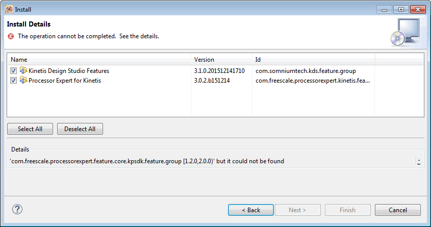

The actions required to successfully install the requested software are incompatible with the software to install.
    Software currently installed: KSDK 1.2.0 Eclipse Update 1.0.1.b150603 (com.freescale.processorexpert.ksdk-1.2.0.sp.feature.group 1.0.1.b150603)
    Missing requirement: KSDK 1.2.0 Eclipse Update 1.0.1.b150603 (com.freescale.processorexpert.ksdk-1.2.0.sp.feature.group 1.0.1.b150603) requires 'com.freescale.processorexpert.feature.core.kpsdk.feature.group [1.2.0,2.0.0)' but it could not be found
Any help would be greatly appreciated.
Hi Detlef,
hmm, I don't know why it requires that SDK 1.2.0 feature. I have to pass this to the engineers.....
Erich
Detlef, it seems you have selected "KSDK 1.2.0 Eclipse Update" check box at the first screen. This update is incremental and can be installed only if you have KSDK 1.2 Eclipse Update already installed.
The recommended instruction for installation KDS3.1 update is using "Check For Updates" (command main menu - Help - Check For Updates). This will install only SW applicable to your KDS.
On clean KDS3.0 installation you will see the following items being updated:Capture.PNG
Regards,Marek
Marek, the "KSDK 1.2.0 Eclipse Update" is marked as "All items are installed" on the 1st screen. When I try a "Check for updates" I get the following:
Full details:
I wonder if the "[1.2.0,2.0.0)" from the last line is a typo in the requirements and should read "[1.2.0,2.0.0]" ?
I was poking around a bit more today, this definitely seems to be the showstopper:
(Added bold emphasis, looks suspicious to me.)

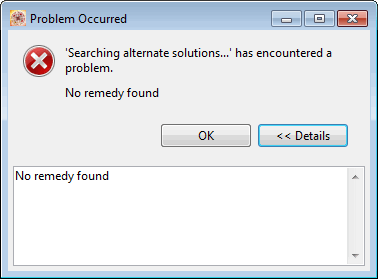

Clarification of my last post: Running "Check Update" produces the "Problem Occurred" and "Available Updates" dialogs at he same time with the former inaccessible until the latter is closed. Unchecking everything GNU and hitting Next in that 2nd dialog results in the following Details error message (note that the message above was there right after the dialog opened):
This is what my installation looks like:2016-02-11_094743.png
I installed it all once and everything works fine... then I reached here. Perhaps I'm a lucky guy? THANKS ERICH.
Hi Detlef, I cannot reproduce your problem on my Win7-64 machine.
If you cannot update your KDS using "Check for updates", I'd recommned to use off-line installer. It can be downloaded from http://nxp.com/kds - Downloads - Download - {sign-in} - "Downloads for Kinetis Design Studio for Microsoft Windows" - "Updates: Kinetis Design Studio for Kinetis 3.1.0 (Windows and Linux OS)" - it is also described above by Erich in response to BOB PADDOCK. Please follow installation instructions described in release notes (included in the ZIP file).
