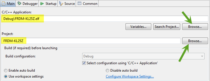

Verify the project and application settings:

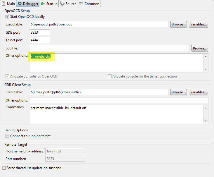

OpenOCD with CMSIS-DAP
Make sure '-f kinetis.cfg' is specified as 'Other Options':

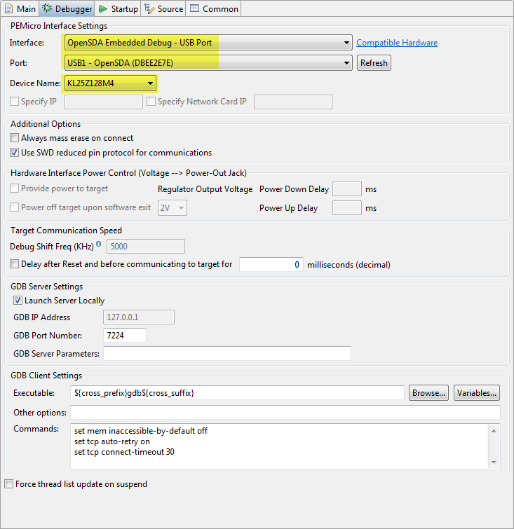

P&E with OpenSDA or Multilink
Select your Interface, Port and Device Name:

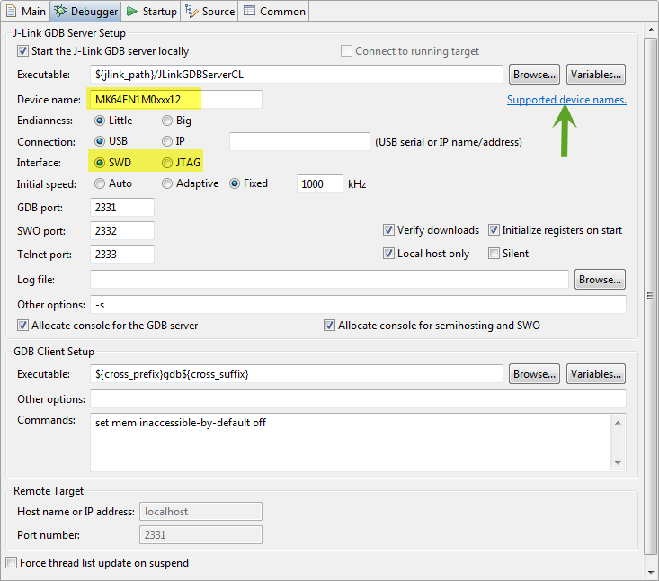

Segger J-Link
Make sure you use the correct device name (link to Segger web page (scroll there down!) lists all supported devices).
OpenSDAv1 and OpenSDAv2 is using SWD.

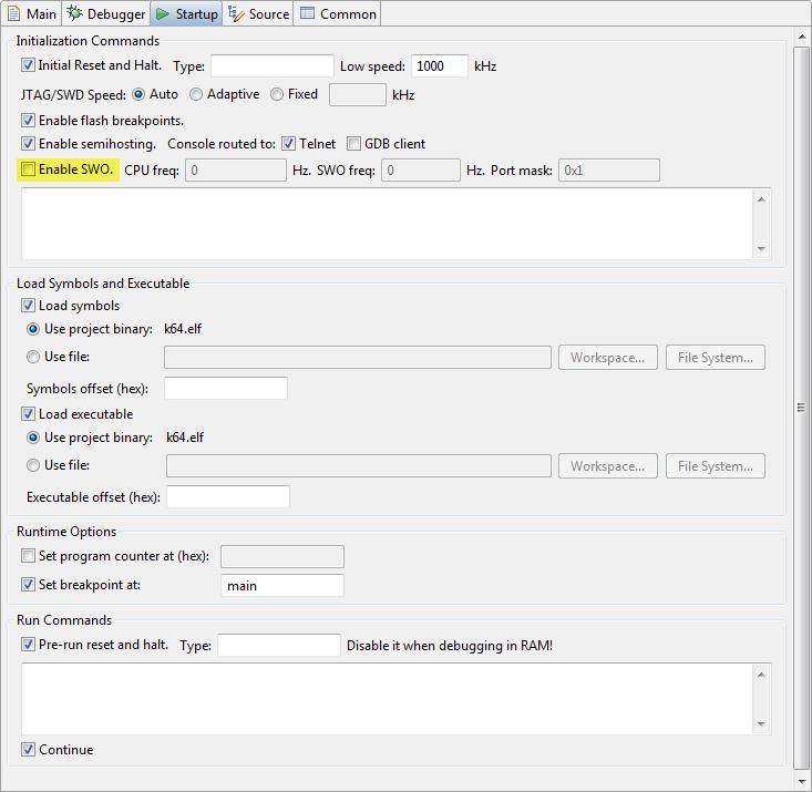

Disable SWO if not supported by your connection:

Heres an image of my debug configuration
The OpenOCD .exe exists on that path.
My Hexiwear docking station has Switch 5, (OpenSDA pin) up and both Switches 3 and 4 up to target the KW40Z MCU.

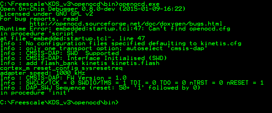

More information that could be helpfull; when i run the openocd.exe from the command line, i get the following text:
Thank you very much for your help

Hi Jaime,
OpenOCD only supports a limited number of Kinetis devices, and if I'm not mistaken, the KW40 is not supported. I have not used it for the KW40 and used P&E and Segger instead. I can look into how to re-program the K20 on the docking station with the DAPLink bootloader, but for this you will need an external probe in any case.
Erich

I am using KDS 3.2.0 by selecting PnE as debug option on the FDRM-KE06Z board. I follow the steps above to configure the Debug configurations. But an error message keeps popping-up:
"Launching xxx_Debug_PnE' has encountered a problem.
Error in services launch sequence
Details>>
PEmicro GDB Launch Failure : Another GDB Server debug session is alreadyusing the same Server Port number. To run simultaneous debug sessions, please specify a unique Server Port and GDBMI Port in the Debug Configuration for each project. If another session is not running simultaneously, make sure that the pegdbserver_console and the arm-none-eabi-gdb processes have terminated.
May i know what's wrong with my PnE configuration on Server Port number? I just have a project file open and build in my project explorer for this time being?
