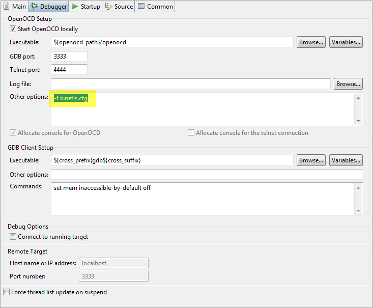

OpenOCD with CMSIS-DAP
Make sure '-f kinetis.cfg' is specified as 'Other Options':

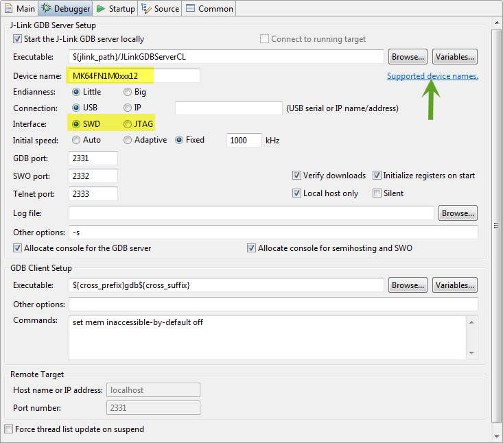

Segger J-Link
Make sure you use the correct device name (link to Segger web page (scroll there down!) lists all supported devices).
OpenSDAv1 and OpenSDAv2 is using SWD.

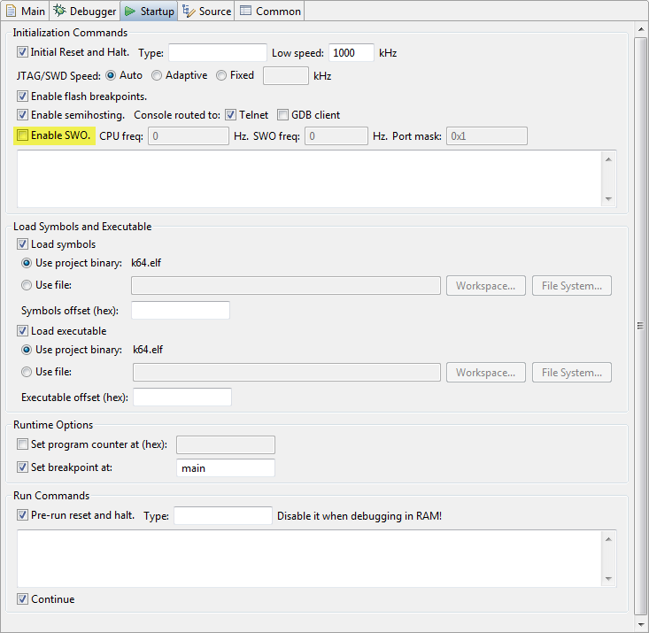

Disable SWO if not supported by your connection:
