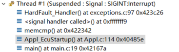

  I need to pass some information from boot to the app,so I think it's a good way to get some uninitialize SRAM section ,and define some variant here,as you can see:
But when I read the values of these variables, there are some hardware failures:
So Maybe there's something wrong with the way I wrote it.
but,how to get a SRAM section without initialize in K312?

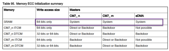

Have a look at the default linker_flash_s32k312.ld and startup_cm7.s, the SRAM ECC is initialized up to __INT_SRAM_END which is ORIGIN(ram_rsvd2). You placed the new section behind that, so it is not initialized.
Before the memory can be read, its ECC must be initialized.
It can be initialized later, but it must be a 64bit write.
The SRAM is retain through functional system reset only.

There can be also issues with the MPU that is initialized in system.c
This would result in a MemManage fault exception.

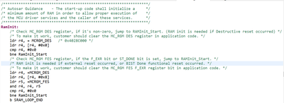

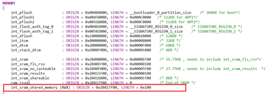

Thank you for your help,I have made modifications to the. s file according to the instructions you provided, and confirmed that the current partition is 0x100, which is a multiple of 64 bits. However, I still encountered a hardware failure
The following are the modifications I made in the. s file:
Reyna_pan45_2-1726690439909.pngReyna_pan45_2-1726690439909.pngReyna_pan45_3-1726690452945.pngReyna_pan45_3-1726690452945.png
Based on the above phenomenon, my question is as follows:
1.Is this modification correct?
2.Can you provide the routine for how to modify and close this fault in the MPU you mentioned?
3.And, after this modification, I found a new issue: it will cause the generated hex file to contain this part of the content. Do you know how to modify this issue?

Problem 3 is caused by my incorrect area definition,
and after your prompt, I have  resolved this issue .
