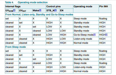

你好,对于TJA1043的应用原理图(page 19)我有个疑问想请教:
TJA1043的INH引脚控制了给TJA1043的VCC引脚供电的5V电源芯片的使能引脚,那么当INH拉低5V电源芯片的使能引脚,5V电源芯片不能给TJA1043的VCC引脚供电,TJA1043没有供电,它如何输出INH信号来拉高5V电源芯片的使能呢
3,354件の閲覧回数
guoweisun
6 返答(返信)
3,385件の閲覧回数

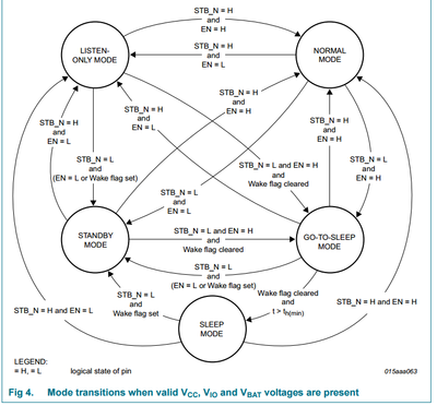

guoweisun
INH 是上拉到VBAT的,通过外部设置STB/EN来控制TJA1043的状态控制INH的H/L,他是一直受控的因为VBAT没断电,比方说上电VBAT以后 TJA1043工作在sleep的模式,STB/EN都是floating的无法唤醒他,那么可以通过本地wake pin 或者Remote wake-up (via the CAN bus)唤醒 让INH 拉高从而让TJA1043 工作:
Any wake-up request, setting the Pwon flag or a LOW-to-HIGH transition on STB_N will
clear UVNOM and the timers, allowing the voltage regulators to be reactivated (at least until
UVNOM is set again).
guoweisun_0-1753941245889.pngguoweisun_0-1753941245889.pngguoweisun_1-1753941263720.pngguoweisun_1-1753941263720.png

Sleep 模式VCC本来就没电了
您仔细看看AH1014 page45:6.2.4 Sleep Mode
Application Hints
3,358件の閲覧回数
loswe
您给的资料中提到了While the microcontroller is completely un-powered (no VCC supply),
the TJA1043 keeps partly alive via its battery supply. It allows the transceiver to monitor
the bus for CAN messages。我理解这就是TJA1043可以在没有VCC的情况下继续监听总线报文的原因吧
