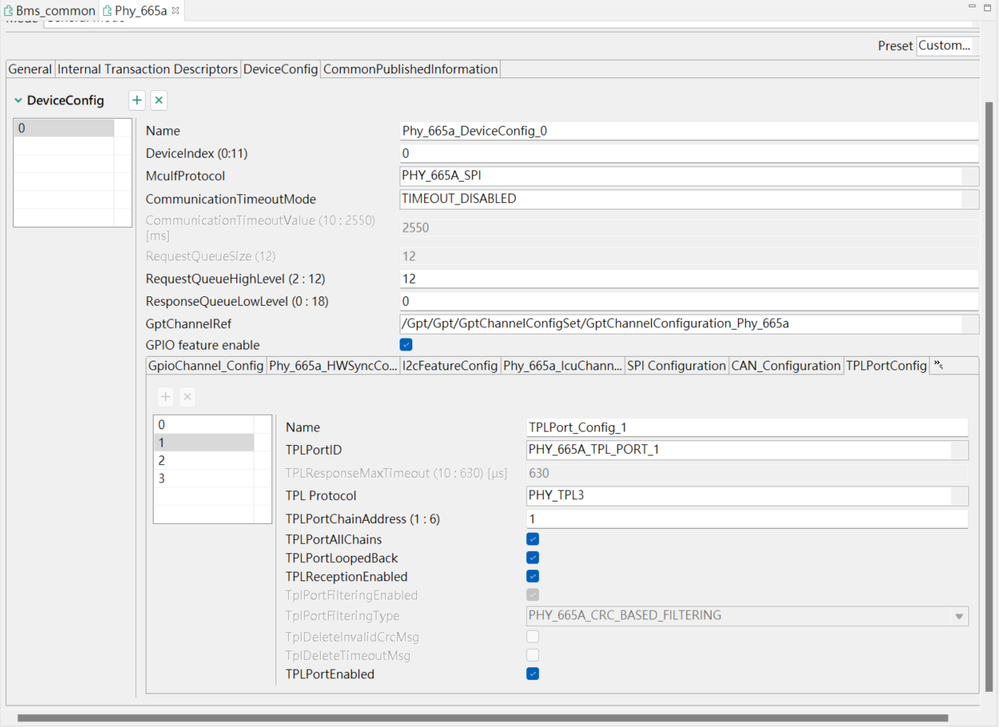

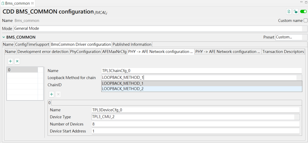

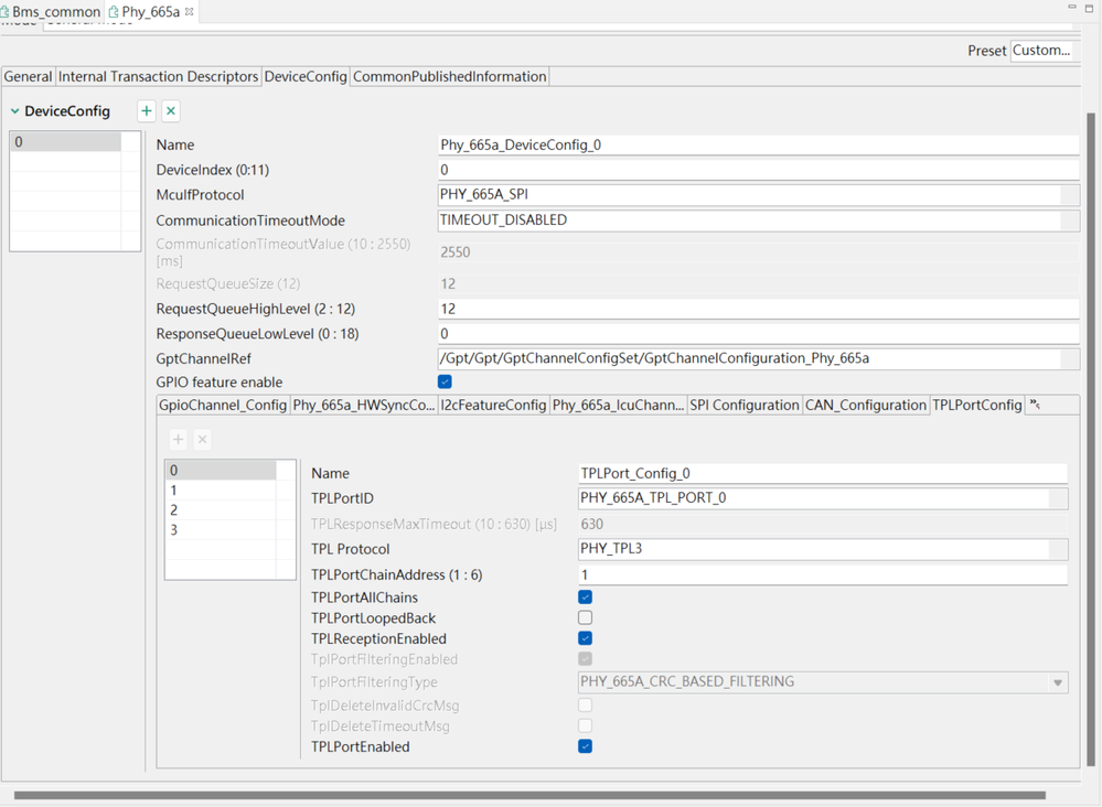

Hi NXP team,
I can transmission/reception data with MC33774ATP using Loopback Method 1.
How should I configure the MCAL to implement Loopback Method 2 and Loopback Method 3?
I've tried setting Loopback method 2, but no data received in actual operation. My settings are as follows (use TPL port0 & port1):
I can't find option of Loopback Method 3 in my environment,  I use RTD3.0.0 & BMS SDK 1.0.1
Are there any example projects that can refer to this requirement? Thanks.

Are you using MC33774 evaluation board?
1,091件の閲覧回数
CHENGYANG
Hi ErikaC,
No, but the board i use reference from RD-HVBMSCT800BUN(S32K358 + MC33665A + MC33774ATP)
1,056件の閲覧回数
ErikaC
Thank you for the information. I am currently reviewing this internally and appreciate your patience.
