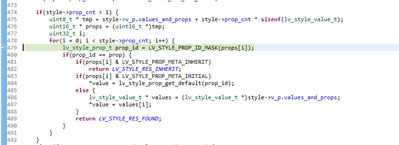

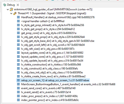

In the GuiGuider Simulator everything worked fine as reported earlier but yesterday I flashed my code on the EVK (using a 800x480 display) and the code runs into a hardfault each time I try to load the screen with the lottie animation on it (see attached screenshot of the debugger)
The line that causes the hard fault is here:
This is just one scenario in which the hardfault is encountered. The hardfault is caused by reading from addresses that our outside the ROM/RAM area (eg 0x0c020608). These invalid addresses occur after executing this call:
rlottie->animation = lottie_animation_from_data(rlottie_desc_create, rlottie_desc_create, "");
on line 113 in lv_rlottie.c
The 'lottie_animation_from_data() call is hidden from the debugger since it resides in the lottie library, so I cannot debug the code any further from here

Thank you for reporting this hardfault issue. The issue is caused by the PNG images which are embedded in the lottie json file you shared.
currently the librlottie.a(for targets) only supports limited features. please try the lottie json files which don't have images.
