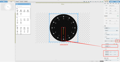

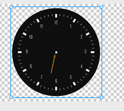

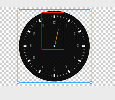

我在使用模拟时钟控件是发现了两个问题:
1.模拟时钟时针、分针、秒针使用图片时,不管怎么调整都无法指向真正的位置
2.转向某一个角度时,图片锯齿特别严重
A:这个角度时,图片没有锯齿
B:这个角度时,图片有锯齿

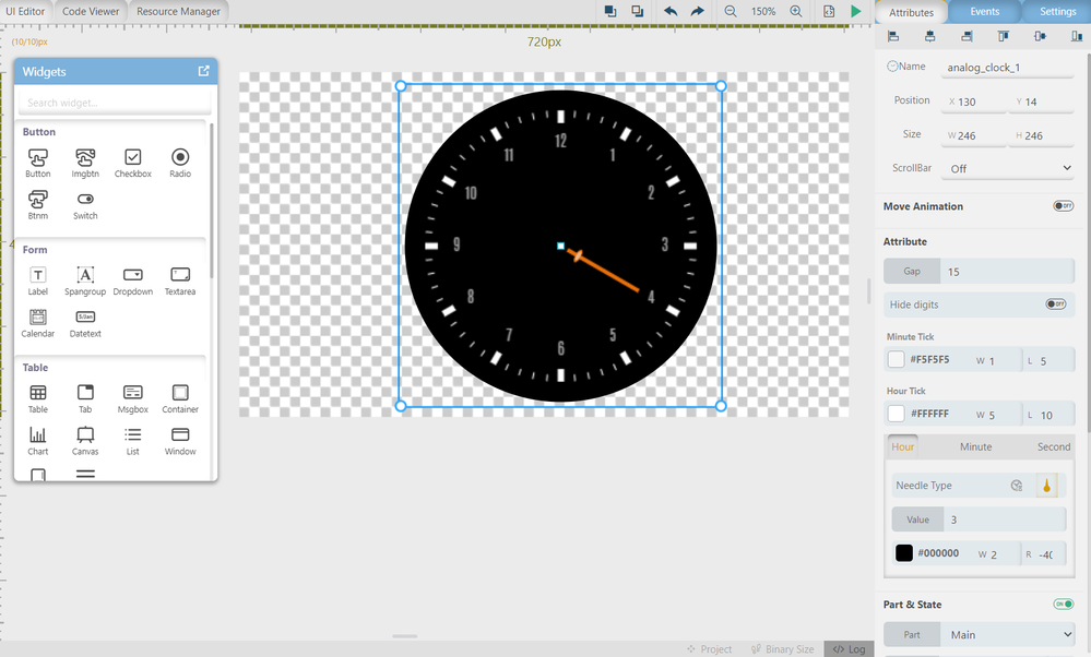

Hi @YoungWind,
Can you please try to change the value of "rotation center" attribute and check if image needle can point to right position? If the issue persists, please share your needle image with us, then we can try to reproduce the issue and find out the solution..

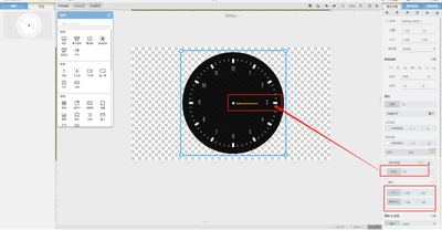

YoungWind
你好!我尝试了通过调节旋转中心来指向我想要指向的位置,但是还是失败了。
以下是我使用到的图片素材

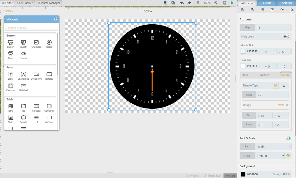

zhenhualuo

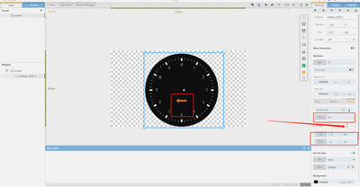

Hi @YoungWind,
Thanks for sharing the image, I have tried the image needle, can you please take a look the value of rotate center setting and check if this is the expected effect?
Zhenhua

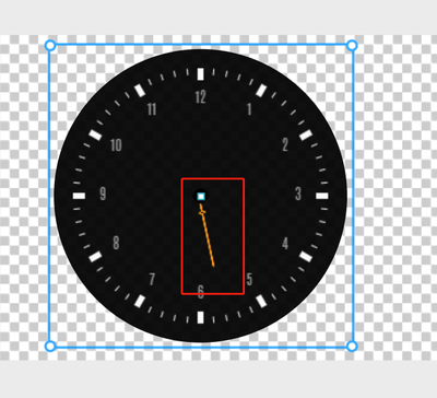

 谢谢你的回复,但是我按照您的属性配置后,发现还是无法实现像您图片中的效果
但是我发现一个细节,您导入的图片指针方向是横着的,我导入的是竖着的,请问图片方向您是经过转换过的吗?

zhenhualuo
Hi @YoungWind,
Yes, I rotate the image to the horizontal direction, please see attached image.
Zhenhua
4,597 Views
YoungWind
好的,谢谢!我实现了。
要是背景和中心的圆点能自定义更改那几太好了

Hi @YoungWind,
Great to see that you implemented the expected effect.
It is a good suggestion to support custom background and center point, we will add the function in roadmap and support in future release. As a workaround, you may use image widget to set the background picture and center point.
