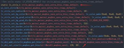

  • I made an UI in Gui-Guider-1.5.1-GA and generated code that failed, like this:
    • So I clicked on code viewer and looked for errors in the generated code.
    • You can see that the variable name in the above code is different from the variable name used belowCloudC_1-1688704204967.pngCloudC_1-1688704204967.png
    • But I can only look at the code and not modify it, so I can only port it to my project code and modify it instead of continuing the simulation.

Hello CloudC,
Thank you for reporting this issue. this issue will be fixed in the next GUI Guider release.
