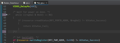

6,099 Views
Ryo_Aoki
Hi zongchunyu.
Thanks for testing. I did some testing and identified the cause.

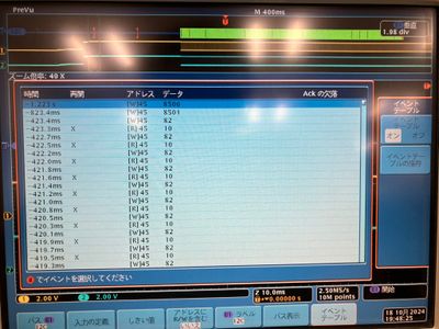

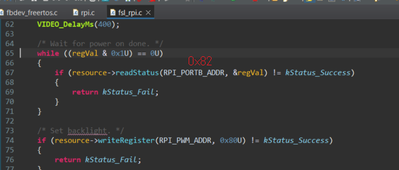

In the source code output from GUIGuider,
I could see that the I2C communication was stuck at a certain point.
It is repeating reading 0x82 to 0x10 of device 0x45 forever.
This is the POWERON wait part of fsl_rpi.c.
Indeed, this code will not proceed to the next step unless 0x*1 is read.
I tried commenting out this section and the display worked fine.
Ryo_Aoki_2-1729232971156.pngRyo_Aoki_2-1729232971156.pngRyo_Aoki_3-1729232999210.jpegRyo_Aoki_3-1729232999210.jpeg

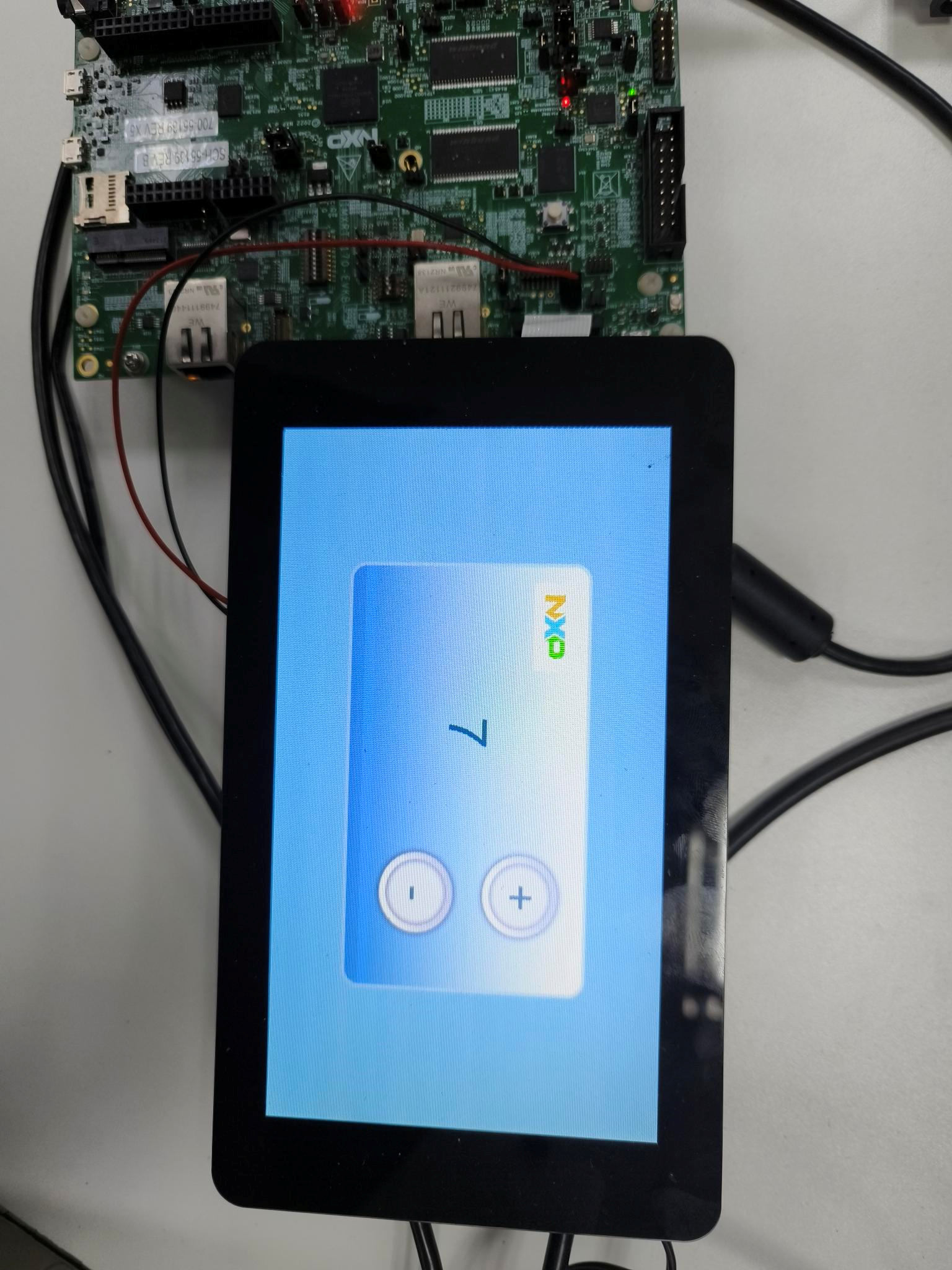

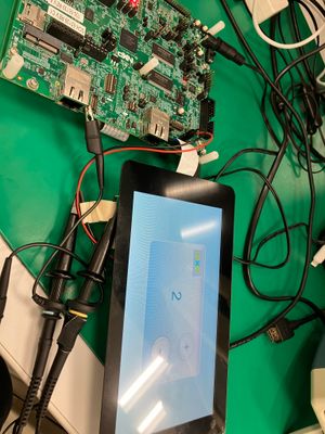

I don't have detailed information about the display,
but I think that the GUI Guider team's display and my display are probably different types, revisions, etc.
If possible, I would be happy if the code output by the tool can run on my own display without any modifications.
For reference, I have posted a photo of the display I have.
Ryo_Aoki_4-1729233057334.jpegRyo_Aoki_4-1729233057334.jpegRyo_Aoki_5-1729233066954.jpegRyo_Aoki_5-1729233066954.jpeg
