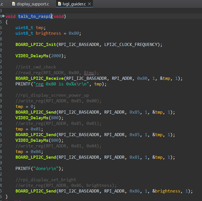

I would like to use the LCD for Raspberry Pi with GUI Guider1.81, MIMRT1170-EVKB, and the RASPI_7INCH option.
However, at the moment, even if I write the GUI Guider sample project, it does not work properly and the screen remains black.
The project on the site below has a working RaspberryPi LCD (probably a project created with GUI Guider).
https://github.com/nxp-appcodehub/dm-lvgl_cluster_rt1170_evkb_rpi

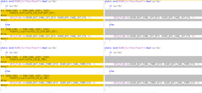

After checking the differences and porting the necessary parts of the source code from github above to the source code output by GUI Guider,
I was able to display the LCD screen.
 -Ported display_support.c
     --left Github src   /   right gui guider output src
     --I guess GPIO control via PCA6416 IO expander is required
 -Ported pca6416.c/h, pca9530.c/h, rpi.c/h
 -Ported the contents of the talk_to_raspi() function from lvgl_guider.c to rpi.c
    --github src  lvgl_guider.c
    -- I think this initialization function is necessary,
        but I think it would be better to have it in rpi.c/fsl_rpi.c rather than lvgl_guider.c where the main function is located.
 -Deleted fsl_rpi.c/h
However, this is an inconvenient situation,
so I hope that they will fix it so that RASPI_7INCH can run as is with the source code output by GUI Guider.

Thanks for testing. I did some testing and identified the cause.
In the source code output from GUIGuider,
I could see that the I2C communication was stuck at a certain point.
It is repeating reading 0x82 to 0x10 of device 0x45 forever.
This is the POWERON wait part of fsl_rpi.c.
Indeed, this code will not proceed to the next step unless 0x*1 is read.
I tried commenting out this section and the display worked fine.
