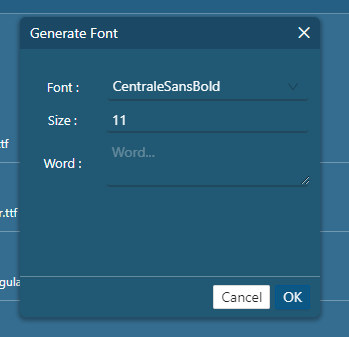

I cannot install fonts in V1.5.0.
The font will be mplus-2p.
With V1.4.1, I was able to install them without any problem.
Do you have any information on this problem?

In GuiGuider 1.4.1 you didn't have a font resource overview, just the 'Assets' tab with your resource images. Importing fonts was a single menu-action and there was no overview of 'installed' fonts on the Assets tab
In GuiGuider 1.5.0 the 'Resource Manager' is introduced and the tabsheets show the images, fonts, Lottie content and Video content. The problem is that, if you import a font in the font tabsheet the font indeed is imported (you can use the new font to use with your widgets) but the new font is NOT added to the list of fonts in the tabsheet of the resource manager. That list only and ever shows the pre-installed fonts that come with the GuiGuider installation.
That's confusing and, again, there is no clue for what the Generate Font button is for

I experience the same difficulties here with installing my own fonts in 1.5.0. Eventually they seem to get generated after adding the .ttf files in the IDE font resource manager. I can choose my 'installed'  fonts in my widget but they won't show up in the resource manager. No idea how my new fonts got in the list of fonts to choose from in the font property of a widget. It is all somewhat not working as expected......
  • should I always 'generate'  a self added font or is that done when the output files get generated?
  • what is the exact method/order to add a font to your project. The manual is not clear about it

There is bug of font import in GUI Guider v1.5.0, can you please try the following workaround?
* Rename the font file to ensure only letter, number and underscore
* Import the font in GUI Guider IDE
* Restart GUI Guider
You will be able to see the imported font in both resource manager and widget attribute window. We will address the issue in new release.

pls explain what I should enter in the 'Word' field so I can generate a fontsize for a self-imported font
There is no explanation in the Manual. Should all symbols that need to be generated be present in that field?

The function is usually used for non-English languages, for example, Chinese. The purpose is to avoid large font file in GUI application, user can only includes the characters to be used in the application, it is useful for resource constrained MCU, the details is available in Chapter “3.9 Generate fonts"  of User Guide.
