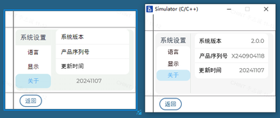

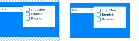

I've built a menu, and added some sub-wigets to it, such as Checkbox, Dropdown. In this fig, I added a container with 3 Checkboxes. But it didn't display as what I set. As you can see, in the Gui Guider, it pre-displayed as the left one. However, in the simulator, it ran as the right (which worked as I wished).
Besides, I'm using Gui Guider-1.8.1-GA on Windows 10.
Could you please help me find out what happened to this?

Hi @ChesterLee
I try to reproduce this issue.
My GUI GUIDER version is 1.8.1 GA
But the layout here is the same as the simulator display.
Hang

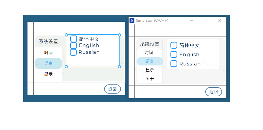

Besides this wrong display, I got another instance. The figure is shown as below.
They are totally different between the UI design screen & the simulator. I set the correct positions of the widgets. However it only displays correctly on the simulator or my MCU device.
Here are some of the widget contents of this screen which may be helpful for you.
I'll really appreciate it if you can help me solve this question!

Can you share your project with me? You can delete most of the widgets and keep only the widgets in the image. So I can reproduce this problem.

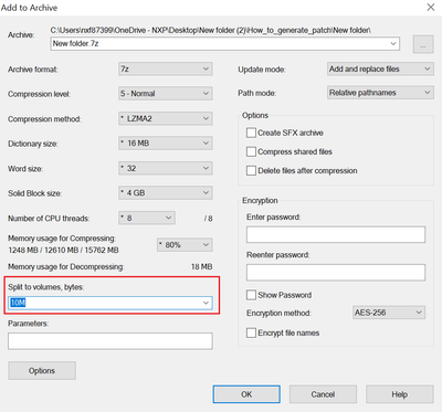

Sure, how could I get in touch with you? Email? Its size is about 40 MB.
4,527 Views
Harry_Zhang
Hi @ChesterLee
You can use 7z compression software.
After compression, transfer the file here.

Harry_Zhang
Hi @ChesterLee
Thank you for your project. I have reproduced this issue and we will strive to resolve it in the next version.

Moring @Harry_Zhang ,
Besides, I want to supply some information -- I created this project on Gui Guider v1.8.0. Then after updating the software, I converted the project from v1.8.0 to v1.8.1. Maybe here's the point about the bug.
Hope it'll be helpful to you!
