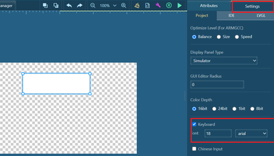

Hello @acd ,
In general, our keyboard is used with the textarea widget. You can put a textarea on the screen and select the keyboard option in the settings directory on the right, so when you use a textarea, it will automatically generate an event, that is, when you click on the target textarea, the keyboard will automatically pop up.
Specific keyboard usage can be found in keyboard.c in the lvgl\src\extra\widgets\keyboard folder of your project.
