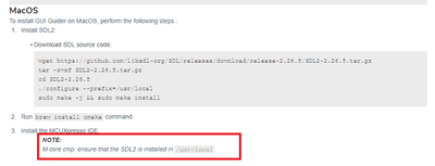

How to figure out the compile error : 'SDL2/SDL.h' file not found
Use MAC OS 12.6 and latest guy guider version.
6,150 Views
LiubinGong
Hi  richen
  Is your computer architecture arm64?  In response to this problem, I suggest that you can install SDL with source code. Please ensure the install path is /usr/local.  Since the current version is not yet supported by M-core laptops, Some functions will have problems. it's predictable. BTW, We will officially support the ARM64 M-core Mac laptop in the next release(1.6.0).
Liubin
5,587 Views
application_ninja
Contributor V
Any update on this? Still a problem on Gui Guider 1.6.1 with a M-Core Mac...
5,578 Views
LiubinGong
Hi @application_ninja
 Please install the SDL based on the steps:
Liubin
3,510 Views
lizm0712
it useful,thanks!
5,559 Views
application_ninja
Contributor V
This worked, thank you!
