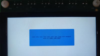

In order to enable wrapping you need to do two things.
  1. Manually edit the width of the label inside the button: lv_obj_set_width(ui->screen_btn_1_label, lv_pct(90)); - the lv_pct(90) value sets the width to 90% of the width of the parent (meaning the button in this case). You can also use an absolute value, like 200. By default it seems that LVGL sets the width to fit the whole text in the label and doesn't take the button width into consideration, which means that the label is created as wider than the button even though it's inside the button and simply enabling wrapping won't have any effect.
  2. Choose the long text behavior: lv_label_set_long_mode(ui->screen_btn_1_label, LV_LABEL_LONG_WRAP);
	ui->screen_btn_1_label = lv_label_create(ui->screen_btn_1);
	lv_label_set_text(ui->screen_btn_1_label, "very very very very very very very long text wrapped with LV_LABEL_LONG_SCROLL");
	lv_obj_set_style_pad_all(ui->screen_btn_1, 0, LV_STATE_DEFAULT);
	lv_obj_align(ui->screen_btn_1_label, LV_ALIGN_CENTER, 0, 0);
