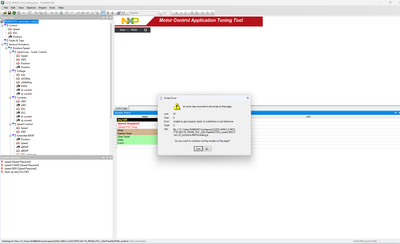

I am using MCSPTE1AK116_PMSM_FOC_2Sh board
while i am tring to open a freemaster to execute the test i got a message that:
Line: 87
Char:6
Error: unable to get property style of undefined or null reference
Code: 0
URL: file:///C:/Users/X/workspaceS32DS.ARM.2.2/MCSPTE1AK116_PMSM_FOC_2Sh/FreeMASTER_control/MCAT/src/JS_f...
do you want to continue running scripts on this page ?
then nothing is running, what shall i do ?

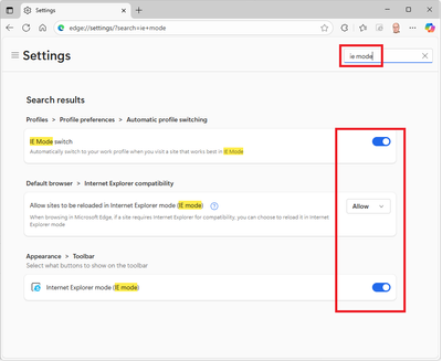

5. Go back to Edge ... settings menu and go the "Settings"
6. There is a search bar in the Settings page, enter "IE mode" there. Then make sure to enable "IE Mode switch", and also enable the IE toolbar button in "Appearance->Toolbar" section:
7. Press the back arrow back two times so you get out of the Edge settings pages.

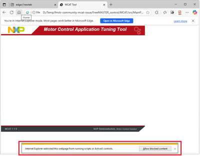

8. Locate the FreeMASTER_control\MCAT\src\MainPage.html file and drag-drop it into the Microsoft Edge window.
9. You will get some error messages (I got some about xmlDoc.load), just ignore them all. After skipping the errors, you should see the page graphics loaded. Note that there is the IE Mode button ready to be pressed.

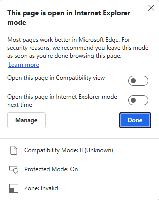

10. Finally the important step which will be different in my and your case. Press the IE Mode button and see the errors you will get. In my case it is the confirmation prompt - press Done
11. Press F5 to refresh the page. I'm getting the "yellow bar" popup with warning about blocked scripts/ActiveX controls. You will probably get a different one.

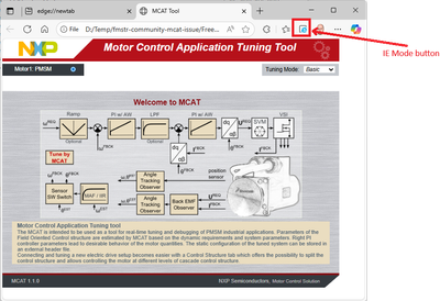

12. After pressing "Allow blocked content" the page becomes operational. In my case, I get no more errors and can change tabs and edit motor parameters. Note that the page is now internally connected to FreeMASTER running in background.
I expect you will get some other behavior and errors in steps 10 and 11 which will hopefully indicate why is the page blocked on your side.
