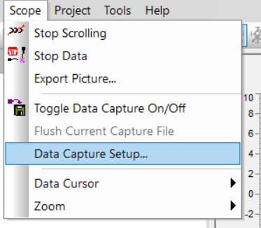

By my experience, old version is showing about Data capture setup like below.
However I did not find same menu at the 3.2 version.
May I ask, how to set up about CSV export by recent version?

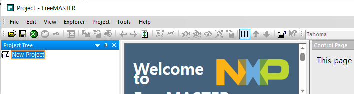

you have to select "oscilloscope" item in the "Project Tree" and wanted menu "Oscilloscope" will appear:
Or right click on "oscilloscope" item in the "Project Tree" and then choose "Properties...":
BR,
Tomas
