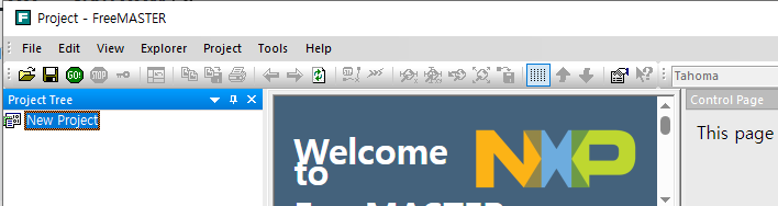

Luke_Chun
Hello Team
May I ask about freemaster?
How to export csv by freemaster by recent version?
By my experience, old version is showing about Data capture setup like below.
However I did not find same menu at the 3.2 version.
May I ask, how to set up about CSV export by recent version?

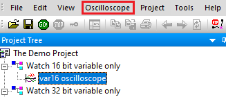

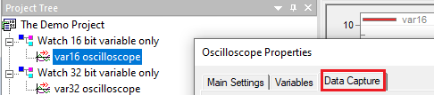

TomasK
you have to select "oscilloscope" item in the "Project Tree" and wanted menu "Oscilloscope" will appear:
Or right click on "oscilloscope" item in the "Project Tree" and then choose "Properties...":
