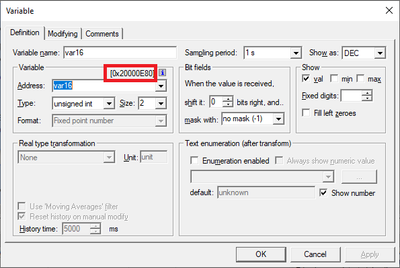

well, it is possible that the FreeMASTER ELF parser is not able to evaluate the array element address correctly. You should see the calculated address directly in the Variable definition dialog, like in this picture:
Can you compare the calculated addresses of elements [1], [2], etc. using the working and not-working versions of ELF files?

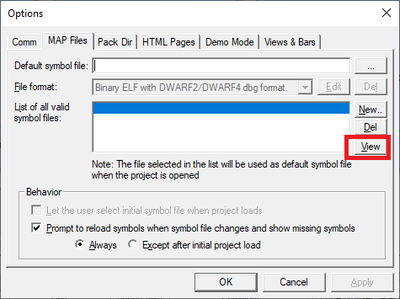

Also, you can dump the ELF symbol list by clicking the "View" in the Project Options dialog:
You can compare the dumps, especially with respect to the size of the problematic array elements. The element size is taken into account when evaluating array indices [1], [2], ... etc.
Please tell us how do the problematic symbols differ.

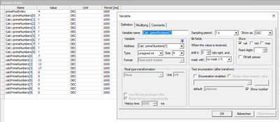

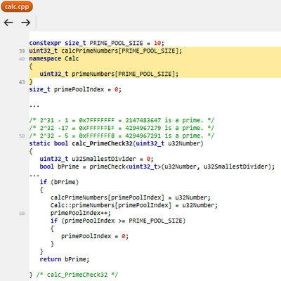

However, I could reproduce this issue with some sample code:
2022-08-16_FreeMASTER_example_code_with_and_without_namespace.png2022-08-16_FreeMASTER_example_code_with_and_without_namespace.png
I generated two array variables and added them to the project.
2022-08-16_FreeMASTER_trouble_with_namespace.png2022-08-16_FreeMASTER_trouble_with_namespace.png
As you can see, the array in the namespace is not displayed properly. Most of the time the wrong value (7) is displayed for the array members > 0. But sometimes also the question mark is displayed. The correct information is displayed in the array which is in the common namespace.
The related information in the text file which is generated by the View button looks like this:
calcPrimeNumbers 0x202c4ebc 40
calcPrimeNumbers[0] 0x202c4ebc 4
_ZN4Calc12primeNumbersE 0x202c468c 40
Calc::primeNumbers 0x202c468c 40
Calc::primeNumbers[0] 0x202c468c 4
primePoolIndex 0x202c4ee4 4
Can you confirm this issue?

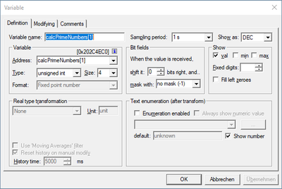

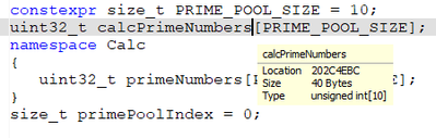

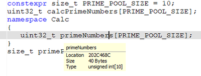

Addendum:
I opened the ELF file with Ozone by Segger to check the array properties. If I move the mouse over the arrays, the displayed information looks all right.
The array in the common/global namespace:
The array in the namespace called Calc:
In Freemaster V3.2.0.5 we use the "Binary ELF with DWARF2/DWARF4 dbg format" to parse the symbols from the toolchain output.
The information for the array in the global namespace is OK for all members.
calcPrimeNumbers[1] = calcPrimeNumbers + 1*sizeof(uint32_t)
0x202C4EC0 = 0x202C4EBC + 4
For  Calc::primeNumbers[1] the address is not shown (compare screenshot in previous post).

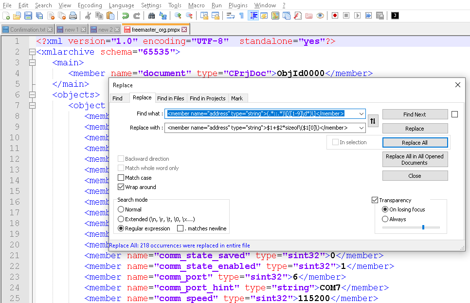

Until the issue is fixed in the next Freemaster version, I patched the project file in XML representation as a workaround. With the help of a regular expression the search can be easily described.
I searched for
<member name="address" type="string">(.*::.*)\[([1-9]\d*)\]</member>
and replaced it by:
<member name="address" type="string">$1+$2*sizeof\($1[0]\)</member>
This only matches arrays in namespaces whose index is greater than zero.
I tried it with Notepad++ V8.4.4:
2022-08-25_search_replace_with_notepadplusplus.png2022-08-25_search_replace_with_notepadplusplus.png
And it works fine.
