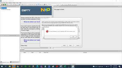

Hi S32K3 team,
I tried both polling & interrupt mode.
UART of S32K3 is not detected by fremaster.
In atteched code CAN, PORT, ADC is working but UART is not detected on freemaster .
Issue is with UART-6.
I set UART base address to UART-6 :--
#define FMSTR_LPUART_BASE 0x40340000
I used :---
  • S32DS-3.5
  • RTD-2.0.0
Freemaster project location :--
  • S32K312_RTD_2_0_0___Tech_day_project\GUI_project\Project.pmpx
    Please suggest why UART port is not detected
Dinesh

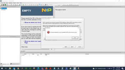

Dinesh_Guleria
I checked on Putty UART-6 working :--
   /* initialize the UART as the console serial communication port */
    Lpuart_Uart_Ip_Init(UART_LPUART_INTERNAL_CHANNEL, &Lpuart_Uart_Ip_xHwConfigPB_6_BOARD_INITPERIPHERALS);
   IntCtrl_Ip_InstallHandler(LPUART6_IRQn, LPUART_UART_IP_6_IRQHandler, NULL_PTR);
    IntCtrl_Ip_EnableIrq(LPUART6_IRQn);
   /* Uart_AsyncSend transmit data */
    lpuartStatus = Lpuart_Uart_Ip_AsyncSend(UART_LPUART_INTERNAL_CHANNEL, (const uint8 *)WELCOME_MSG_2, strlen(WELCOME_MSG_2));
    if (LPUART_UART_IP_STATUS_SUCCESS != lpuartStatus)
        ///return FALSE;
        while(1)
            __asm volatile ("nop");
So issue seems to be with freeMASTER.
I set the PORT address of UART correctly in file --> freemaster_cfg.h.
Please suggest what could be the issue ?
Dinesh

Dinesh_Guleria
I created new project in S32DS-3.4.. imported the MEX file from S32-DS-3.5.
Even I tested on S32DS-3.4, same result .
DInesh

Dinesh_Guleria
Issue solved with Open SDA firmware version 1091.
