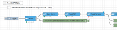

Still confusing. Could you explain where to add (+changes) the .fmcfg file that is created from the Freemaster project to use it for the Freemaster Lite access to get rid of the read variable failure.

iulian_stan
You pass the .fmcfg as a single input argument to node.exe when you start FreeMASTER Lite, or just double click it to launch the tool (the extension file should be registered with the executable). On startup, FreeMASTER Lite parses the file and all variables should be available at run-time.
Node-RED is not aware of those variables because it works as an API consumer. It dispatches RPC commands to FreeMASTER Lite and the later one is in charge of the execution.
FreeMASTER Lite should be instructed to start Node-RED, if you use the instance embedded into FreeMASTER. Add `node_red` property to the .fmcfg file. It accepts a boolean `true` to use default configuration or path to your settings.js (which stores Node-RED specific configuration and is not related to you FreeMASTER project).
Could you also check how many symbols are extracted by `ReadTSA` (just add its output to a debug node). Also, what error is logged by the debug node succeeding `ReadVariable` ?
Iulian

I get connection but there is no TSA read, the count is 0.
"port": 8090,
"web_root": "C:\\NXP\\FreeMASTER 3.1\\FreeMASTER Lite\\html",
"open_path": "/",
"node_red": true,
"connections": [
"name": "S32Kxxx UART",
"description": "Default connection",
"connection_string": "RS232;port=COM9;speed=115200;tmoRI=40;tmoRTM=40;tmoRTC=50;tmoWTM=40;tmoWTC=50;"
"variables": [
"name": "CurrentAverage",
"addr": "CurrentAverage",
"size": 4,
"type": "int"
I does not read the TSA and therefore not the variable.
msg : Object
object
payload: object
count: 0
message: ""
msgid: "c408ea786
If I connect with FreeMaster directly then I see the value.
Cannot find the failure...
10,102 Views
iulian_stan
Hi Bernd,
Unfortunately I cannot say what may be the cause of the issue as the TSA call passes, additionally, the `message` property of the returned object is also empty which overwise would contain an internal error message.
Is it possible for you to share your project ?
As a workaround I could suggest using ReadELF node. For this you'd need to add `elf` property to your `connection`, as described in my previous message.
