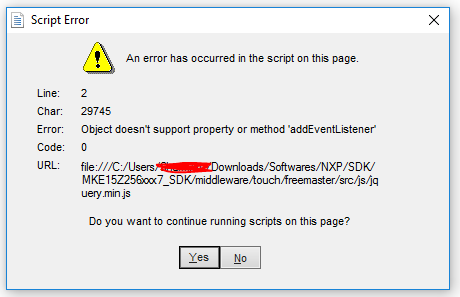

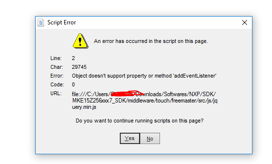

When I open this file I get a lot of errors in running the javascript files.

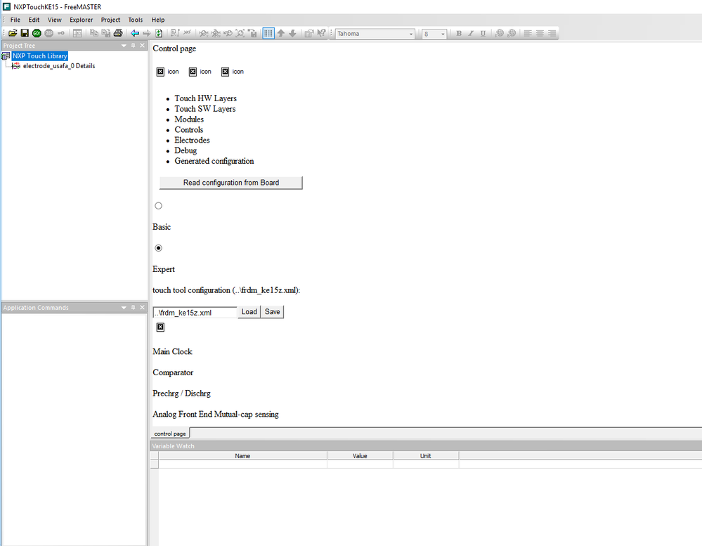

And Finally after clicking on "Yes" multiple times it looks like this.
Please suggest, what I am doing wrong.

this seems like an issue with Internet Explorer compatibility. FreeMASTER uses IE component internally to render the HTML control page. All restrictions which limit IE functions also affect FreeMASTER.
Please check the following:
  • Are you able to run the IE for general internet browsing?
  • Make sure you open the FreeMASTER project from local hard drive (not a network-attached shared drive)
  • Open menu Tools/Internet options and select the Advanced tab in the dialog. In the Security section, makes sure you have "Allow active content .... to run on My Computer".
  • With FreeMASTER open, try to open the touch control page HTML in the standalone IE. Just to see if it throws the same error...

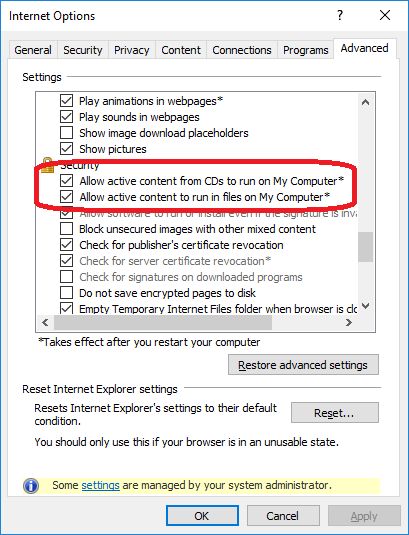

I tried to enable the "Allow Active Content..." option, but unfortunately, I didn't this option.
This is my office laptop running on Windows 10 (I have admin rights).
Is there some other way to fix it?

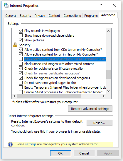

So, it indeed seems that the Internet Explorer is not allowed to display pages with JavaScript-based Active Content. Most probably, your employer has also disabled access to the Advanced IE properties. There are two ways how it is normally done - in Policy Settings or directly in the Registry. Both ways are described in this article.
I recommend you to discuss the limitations with your administrator and see how you could gain access the advanced IE settings to enable the Active Content. If the page still does not work after it, we will investigate further.

Thank you for your response. I checked the link you suggested and changed the registry value and now I have the advance option available in Internet Options, and after changing to allow active content, this is not working now also.

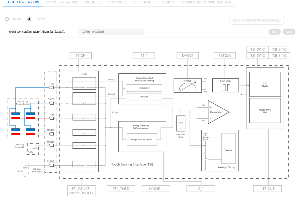

And when running on Internet Explorer, it looks like running, but all button looks disabled.

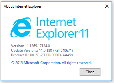

can you run the Internet Explorer and go to menu Help/About? Show me the version information please.
I have another question: when FreeMASTER is NOT running, and you open the touch HTML page in a standalone Internet Explorer - does the FreeMASTER start automatically or not? And does the IE show any yellow information bar at the top of the window?

Regarding Internet Explorer Version, please see the below screenshot.

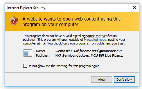

And regarding your other question, FreeMASTER doesn't open itself when I open the Touch HTML page in Internet Explorer.

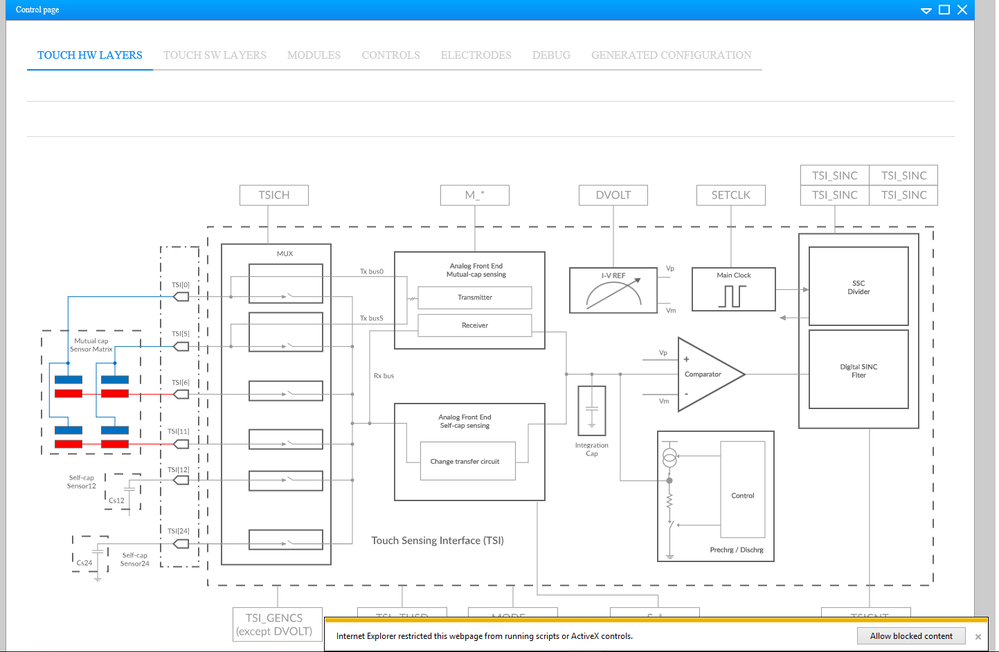

And when I open the HTML file I get a yellow information bar, asking for Allowing the blocked Active X Content, by allowing Internet Explorer displays as shown below, but none of the buttons are working.
I have another personal laptop, on which this is working fine, but I don't understand why it is not working on the office laptop.

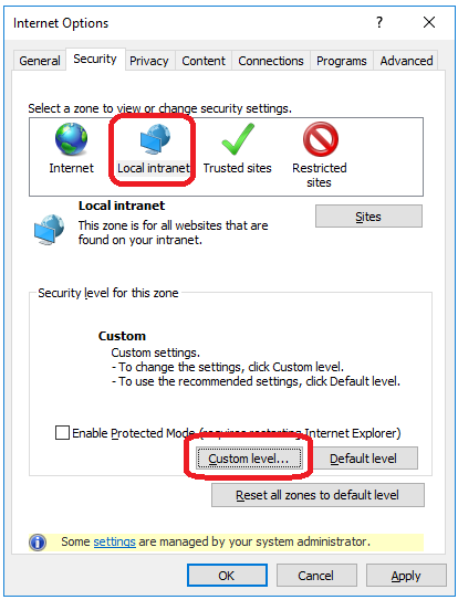

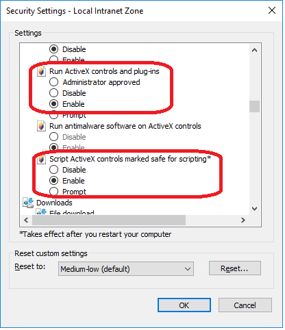

it seems the ActiveX scripting is also disabled somewhere else. Can you check the Internet Options - the Security tab? Select the Local Intranet and press Custom level... Then enable the items as in the picture below. Also do the same for Trusted sites zone.
Michal

Unfortunately, this setting is also disabled on my office laptop.
I will check with my IT team if this can be resolved at there end by doing some changes or not.
