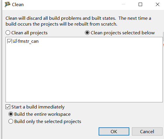

443115228
Hi Michal,
    Thanks for your reply.
     I have downloaded FreeMASTER3.0,but I can't find the example code.So I'm using  fmstr-s12z-2019-12.zip attachment.
     One error occured when I using the example code,and it can not be cleaned.please give me some advice.
quangui
9,388 Views
MichalH
NXP Apps Support
NXP Apps Support
Dear Quangui,
you are right, there was an absolute path to /project_settings/mc9s12zvml128.c in the .project file. You can edit the .project file, locate the path and change its entry to
   <locationURI>PARENT-1-PROJECT_LOC/project_settings/mc9s12zvml128.c</locationURI>
or you can download a fixed zip file attached to the the original article. I have updated it there just a moment ago.
Michal

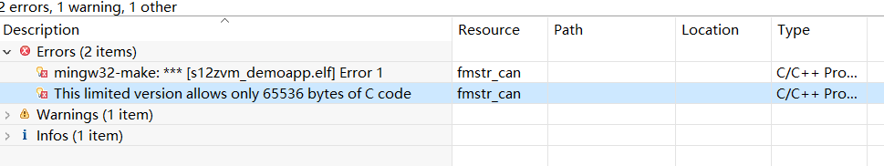

   The previous error was cleared, but two other errors occurred.
  How can I solve this problem?

Dear Quangui,
the free CodeWarrior license that you probably use only lets you to build applications up to 64k of code. You need to make the application smaller, or you need to get the full CodeWarrior license.
The FreeMASTER demo is quite large by default because it contains the whole project file and couple of HTML files and images compiled in the application for demonstration purposes. With this feature, you are able to load and open the project directly from the board Flash memory.
You may make the application smaller by turning off some features in the application's freemaster_cfg.h file:
  • Set the FMSTR_DEMO_LARGE_ROM to 0 and see how it impacts the code size. This option disables putting the files into the Flash memory.
  • Turning off the FMSTR_DEMO_ENOUGH_ROM will disable even smaller text files and links put to the Flash memory for demonstration purposes.
  • Turning off some of the FreeMASTER features will make the image even smaller, but you will loose functionality. For example turning off FMSTR_USE_TSA will remove all code and data used by TSA feature. Read about other features in the driver's user guide.
Michal

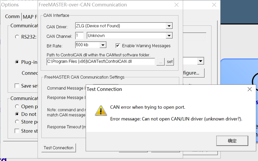

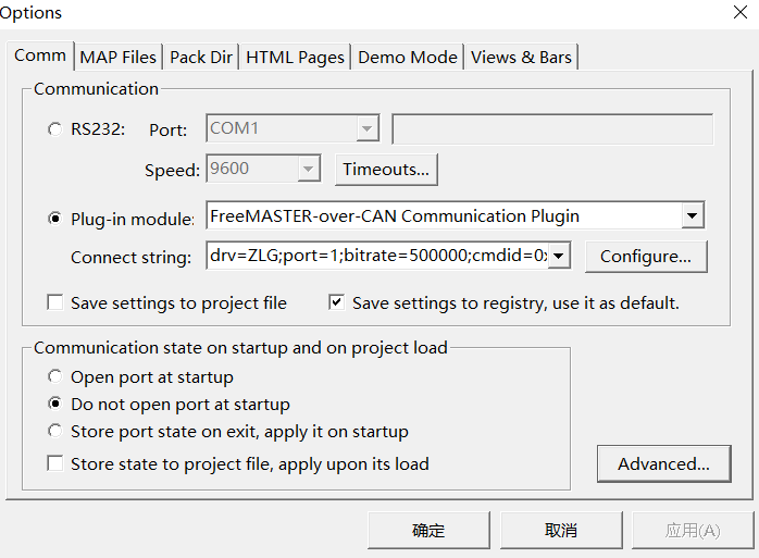

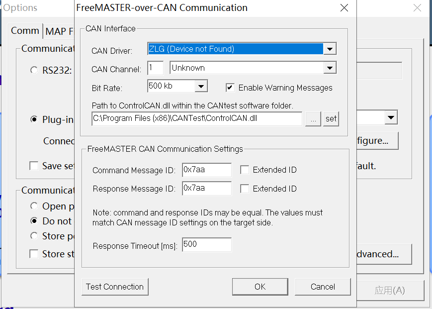

443115228
Dear Michal,

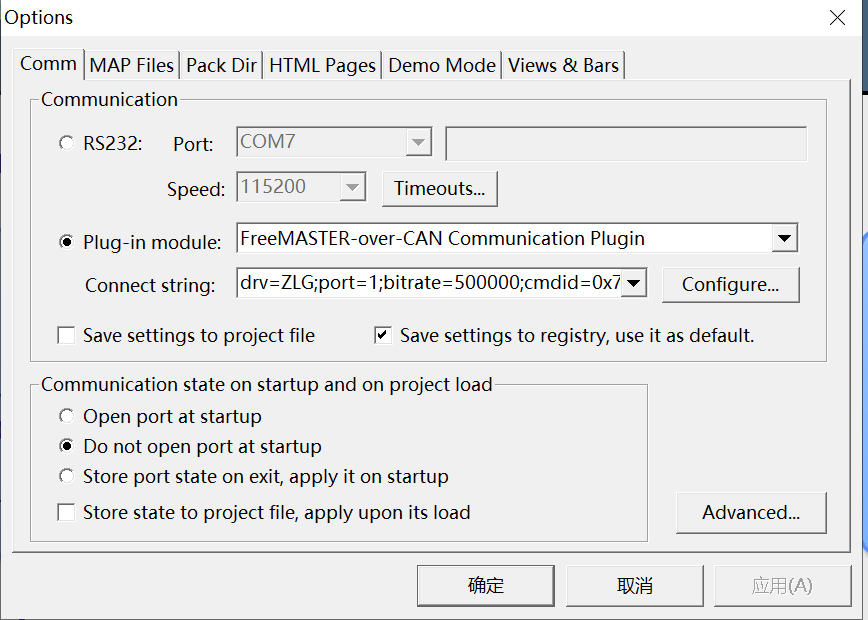

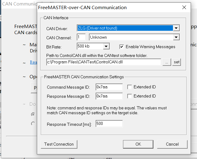

     I solved the problem according to your suggestion. Now the program can be downloaded to my board, but freemaster can not communicate with my ZLG usbcan_2e_u.Please see the pictures below.
In fact, my usbcan_2e_u can work with the cantest software, please see the picture below.
Quangui
9,388 Views

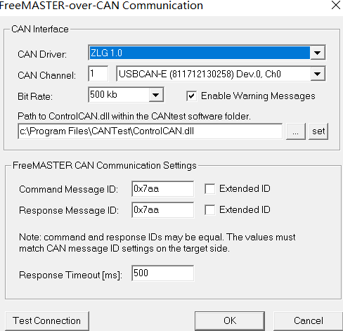

443115228
I solved this problem by changing the ZLG software installation directory.We have to install ZLG in
C:\Program Files\CANTest .Although the identified hardware version number is wrong, it does not affect my use
Quangui

Dear Quanqui,

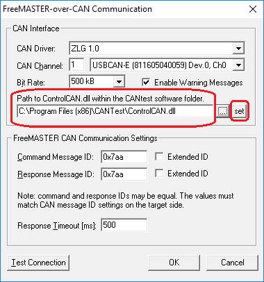

thank you for your latest update. The hardware device name is retrieved directly from the ZLG driver. Also in my case, it shows USBCAN-E for my USBCAN-2E-U device. I think this is a normal behavior.
Just FYI: You may still install the ZLG to a custom folder, you just need to set a path to this folder in FreeMASTER CAN plug-in configuration dialog.
