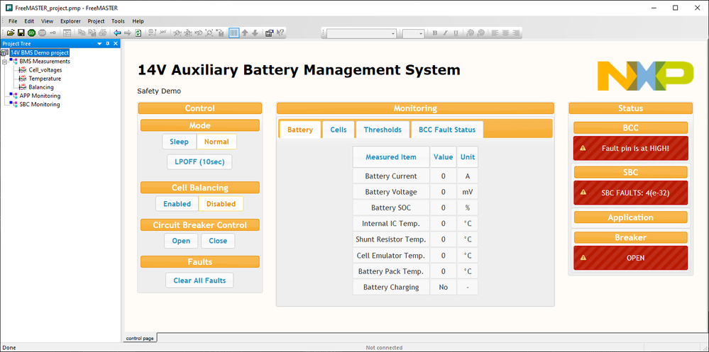

I am using the NTBMS evaluation board.
Use FreeMASTER File provided by NXP.
(File Download Link : https://www.nxp.com/webapp/Download?colCode=NTBMS_SW)
However, when I load the project file, a script error occurs.
Click Yes to the various error messages and run the demo.
The demo program stops shortly after.
I need your help..

After running this example on my side (note: I'm not familiar with this application nor BMS systems), I noticed that the first page displayed in FreeMASTER is actually application home page from NXP site. FreeMASTER is not a fully featured web browser, thus some JS scripts are failing, to avoid this behavior I would recommend removing that page:

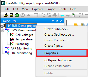

1. Right click on root element in Project tree, and open properties (it may be a bit annoying because you need first to close those popup errors)

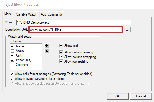

2. Clear the  "Description URL" input field (you can open that link in a web browser if you need it)

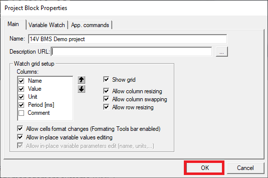

3. Confirm the change
Now you should see the BMS application control page. I don't have the setup to confirm the functionality but, after removing the link to NXP site I had no more JS errors.
To persist this change make sure to save the project.

Thank you.
The above problem has been resolved.
