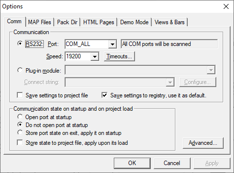

in my case the FreeMASTER can run with no issue. Please check following steps:
  1. After successful importing and building project click on Debug Item near left bottom corner of your MCUX IDE 11.2.0_4120. In my case the mbed debugger and serial port is used.
  2. Now you can disconnect the debugger and press reset on the board or keep debugger running, both variant are working correctly.
  3. Check if the example is running - the LED should change the color after some electrode was touched.
  4. Run the Touch FreeMASTER file directly by double click from MCUX IDE from the Project Explorer -> touch -> freemaster -> src -> NXPTouchkez15.pmpx.

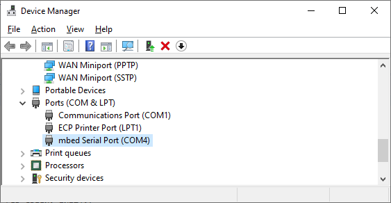

  5. Click the Go button in the FreeMASTER, all COMs will be scanned with speed 19200, in my case the board was detected on COM4. pastedImage_4.pngpastedImage_5.png
  6. Now the touch state from the board should be visible for example.pastedImage_7.png

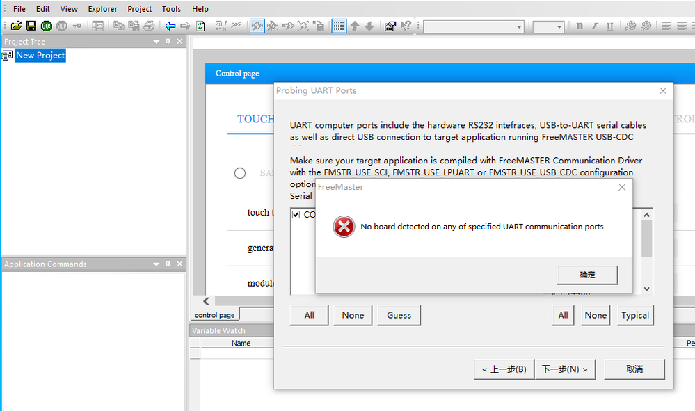

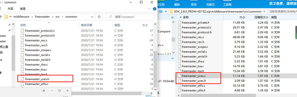

   To the version 11.0.1_2563, I used the SDK 2.7.0,and to the version 11.2.0_4120,I used the SDK 2.8.0. I just checked the SDK zip, found the file  freemaster_ures.c,but the unzip folder has not the file ,so amazing.I copy the file into the the unzip folder,now it can build successfully.
After that,I downloaded the program,and disconnected the MCUX IDE11.2.0_4120. But FreeMASTER also can't connect the board,the following picture  shows the error (the FreeMASTER project "NXPTouchkez15.pmpx"  imported from SDK_2.8.0_FRDM-KE15Z\middleware\touch\freemaster)

I'm sorry I don't know the Touch solution for KE15, but from the error it seems that the file freemaster_ures.c is not added to project. Do you have the file in the Touch demo installation? If yes, please add it to project. If not, let me know.

Dear Michal,
      I have been built successfully.I downloaded the program,and disconnected the MCUX IDE11.2.0_4120. But FreeMASTER also can't connect the board,the following picture  shows the error (the FreeMASTER project "NXPTouchkez15.pmpx"  imported from SDK_2.8.0_FRDM-KE15Z\middleware\touch\freemaster).微信图片_20200803172432.png

1141886202
 As you said , the project don't have the file freemaster_ures.c .But I can't find the file in the SDK_2.8.0_FRDM-KE15Z\middleware\freemaster\src,and I didn't find the file on my PC.

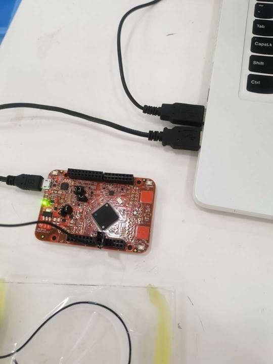

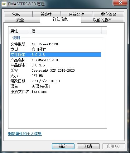

     I installed the newest version 3.0.3.6,it also showed   "one or more newer versions of the product are already installed.An upgrade is not applicable."Beside, I tried to uninstall MCUXpresso and delete all folder about NXP ,after that I try again install  the newest version 3.0.3.6,the question still exist.
    The project what i used is frdmke15z_tsi_v5_selfmodd which imported from SDK example(SDK_2.x_FRDM-KE15z  2.8.0).And I used the USB to connect the Board,now Ican Debug it.
