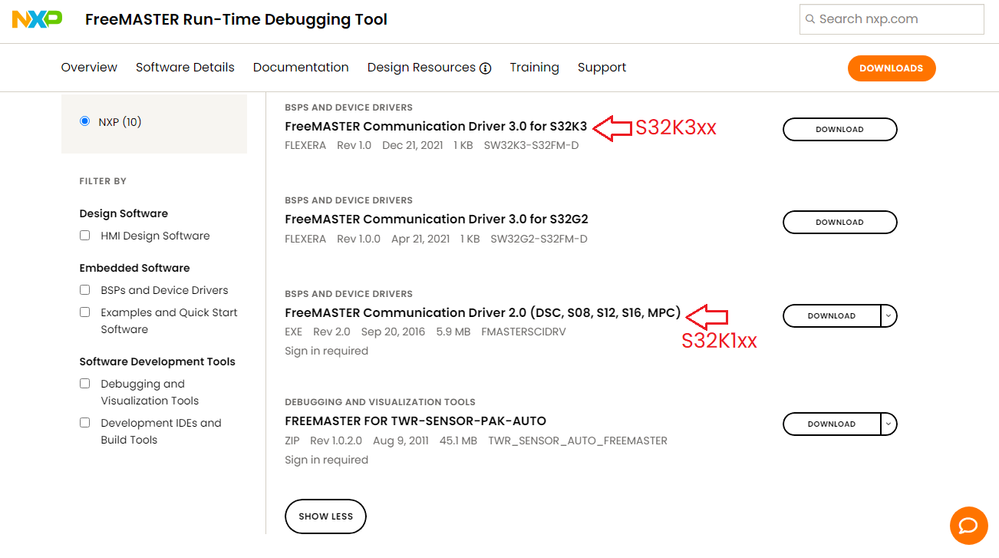

Coding_Torque-SDRS
Hi @iulian_stan Which FreeMASTER Communication Driver will support the S32K1xx series uC - here are the list of drivers available - please refer the screenshot i attached.

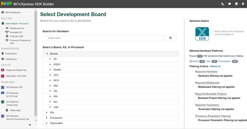

Coding_Torque-SDRS
Hi @iulian_stan The link you shared helped me in someway, but i'm still having issues in installing freeMASTER Communication Interface - I'm using S32K144EVB and S32K3 series EVB's but in select development board there is no option for selecting this board - Screen shot has been attached.

iulian_stan
Packages for automotive platforms (S32x) are not distributed via MCUXpresso SDK builder.
S32K1xx software support can be found on https://nxp.com/s32k1
In terms of FreeMASTER Driver, those can be found on https://nxp.com/freemaster
Note: S32 Design Studio is the IDE for automotive platforms.

iulian_stan
Hi @Coding_Torque-SDRS,
In order to use all features of the FreeMASTER(desktop tool) you need to add a FreeMASTER Driver to your embedded application - check this post for more details about FreeMASTER Driver - Communication Driver - Application Configuration
If you did not add FreeMASTER Driver you still can use FreeMASTER tool with limited functionalities. In this case you need to configure BDM communication plugin - refer to the README file included in FreeMASTER installation folder C:/NXP/FreeMASTER 3.2/FreeMASTER/plugins/bdm/doc/bdmpgi/Readme.htm for BDM plugin configuration.
