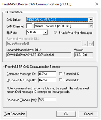

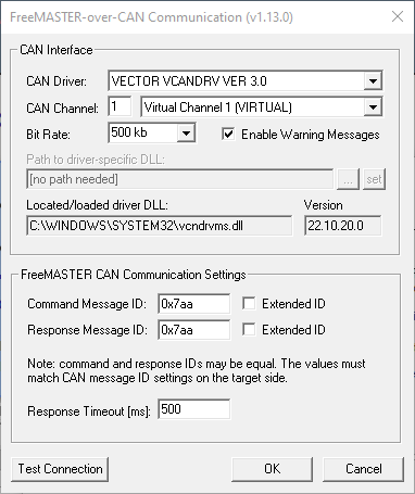

I did successfully connect FreeMASTER with MPC5566 through CAN, but on some computer FreeMASTER can open the CAN port and some don't. FreeMASTER warns me that could not open the communication port(Error 0x848c0003:Can not open CAN/LIN port or channel.)!) . Could you please tell me how to set up the FreeMASTER by communication through CAN?
5,640 次查看
iulian_stan
FreeMASTER CAN plugin uses underlying (vendor specific) driver to communicate with target board. This errors is thrown when the external driver fails to establish the communication channel.
Are you using the same version of FreeMASTER ? same probe ?
If so, can you check the CAN interface configuration from the PC that connects to the board with the one on which it fails. I am referring to the top part of this screen:
I can think of the following potential issues:
  • Driver is not identified correctly or uses a wrong channel.
  • Driver is not found or has an older version.
Kind regards,
Iulian

MichalH
NXP Apps Support
NXP Apps Support
can you tell what CAN interface do you use? If it is a Vector card, you can also test the newer VECTOR-XL driver interface.
Michal
