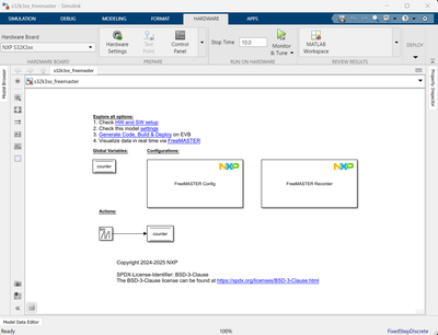

I want to use the freemaster function with Matlab and Simulink (with Model based design). I haven´t found any project or example about this topic, so I don´t know if someone have some project about this. (I am using a microprocessor of S32K344 family). Moreover, I don´t know where is the guide to use freemaster y how I can crew a new interfaces.
My target is to create a new interface where I could see all variables and generate a new plots with those data.

Hi @JonAnder ,
Yes, we have examples for S32K344 that use the Simulink Blocks for FreeMASTER, called s32k3xx_freemaster.mdl inside the S32K3\src\S32K3_Examples\fm\s32k3xx_freemaster\ folder

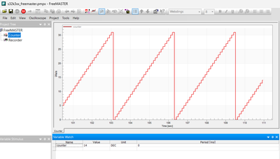

after you press CTRL+B (build and deploy) you can open  s32k3xx_freemaster.pmpx and visualize the data in FreeMASTER:
you can also open FreeMASTER Config block and press on Help, it will open a new Documentation window with details about it:
What version of MBDT for S32K3xx are you using?
