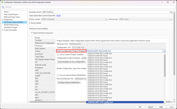

  • Default Configuration Project Templates targeting all the supported S32K3 derivatives
The toolbox delivers default configuration projects, available in both S32 Configuration Tools and EB tresos, covering an initial enablement of the on-board peripherals, pins, and clocks, for all the supported S32K3 derivatives. The desired template, which represents the starting point for enabling the hardware configuration of the application, can be selected via a dropdown widget.
  • Support for creating and using Custom Project Templates
The toolbox provides support to use and create custom project templates. This could be very useful when having a custom board design – offering the possibility to create the configuration for it only once. After it is saved as a custom project template, it can be used for every model that is being developed.

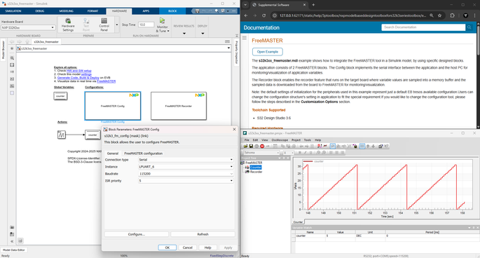

  • FreeMASTER Integration
We provide several Simulink example models and associated FreeMASTER projects to demonstrate how our toolbox interacts with the real-time data visualization tool and how it can be used for tuning embedded software applications.

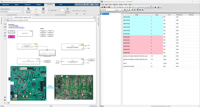

To demonstrate the integration and support of the GD3162 gate driver IC, we have included a reference Simulink application that configures six GD3162 devices in   a daisy-chain topology using SPI communication. The setup enables sequential initialization, configuration, and status monitoring of each GD3162 device using the S32K396 as a controller MCU.
