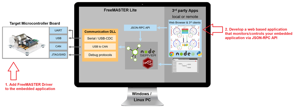

How Can I use FreeMasterLite to provide remote access for clients to the target microcontroller?

The following pictures shows (on a very high level) what has to be done:
FreeMASTER Lite has a built-in web server that can host the web application that you develop in step 2 (in the above image). When you start FM Lite executable, specify the path to your web app like this:
node.exe --web_root "C:\My_FreeMASTER_Lite_App"
Once it is running, you can open your local web browser and navigate to `localhost:8090` or `127.0.0.1:8090` and check your application. (8090 is the default port number, it can be changed using `--port` argument)
There are no additional steps required to access it from a remote PC. You just need to get the public IP address of the machine FreeMASTER Lite is running on, and open it on the remote PC.

thank you very much dear iulian. but I don't understand where I can write the path of my web app?  when the FM lite operates it shows this screen
which even has no capability of writing in it . and then immediately open this default page
I think I should make something to show my own web page in the web server and then the remote PC can navigate to my IP to see the same web page I see and then he can control the target board from his remote dashboard isn't that right?

By default, FreeMASTER Lite, serves the web content from the 'html' folder that is located inside the installation directory.
You can either:
  • put your file in that folder "C:\NXP\FreeMASTER Lite 1.2\FreeMASTER Lite\html", or
  • specify the path to the folder that contains your web page vie command line argument "--web_root" or "-w".
