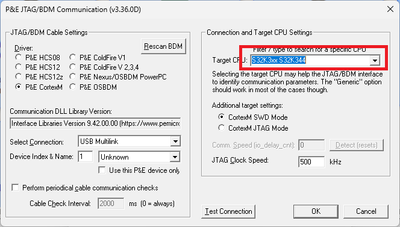

There are two important points:
  1. The S32 Design Studio (debugger) must be disconnected from the target when attaching FreeMASTER. The P&E probes cannot handle simultaneous connection from two client applications.
  2. The FreeMASTER plug-in shall know what MCU part number you are using.  Go to Project/Options, open the configuration dialog and select the MCU type like in the picture below:

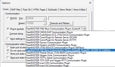

from your screenshot it seems like a problem in FreeMASTER installation. The communication plug-ins are probably not installed properly. You can confirm this by going to Project/Options - the drop-down list of Plug-in modules will probably be empty in your case:
How to fix the installation:
  1. Close FreeMASTER
  2. Open file explorer in "c:\NXP\FreeMASTER 3.2\FreeMASTER" directory
  3. Locate the "register.bat" file
  4. Right-click the file and select "Run as administrator"
  5. Start FreeMASTER, the plug-ins shall now be visible in Project/Options dialog.
Michal

Stark_
Hi @MichalH
Thanks for the quick response.
As you said " Project/Options - the drop-down list of Plug-in modules will probably be empty in your case " was correct and followed the step you mention, after that can able to see the plugin in FreeMASTER. when i try to run with the mention setting (i.e, FreeMaster P&Emicro communication plugin (Cortex-M, power pc, HCS08/12, Cold fire) ). but again got an error message.
Is is possible to use FreeMASTER with P&Emicro debugger? for that any lib should be added in project file ?

Stark_
Hi @MichalH
once I flash my microcontroller after that i just connect with FreeMASTER. but it show an error
MCU is used is S32K3 series
P&E micro Multilink universal FX
IDE used S32 Design studio
Michal
10,953 Views
Stark_
Hi @MichalH
Connection are done
when i start the communication popup show for for load the executable file, I also load the .elf file which is created in my project.
