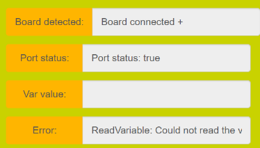

First problem,
I started with simple variable reading. I use the following fields for feedback.
Here we can see, that I received a positive feedback from the pcm.OnBoardDetected and from the pcm.IsCommPortOpen() methods. Only after that I tried to read a variable, but I received the following error message: "ReadVariable: Could not read the variable 'FMSTR_u32FwVversion[0]'. Error 0x8000fffb (Communication port is not opened.)."
Interesting is, that when I call the same ReadVariable method manually with a button, it works.

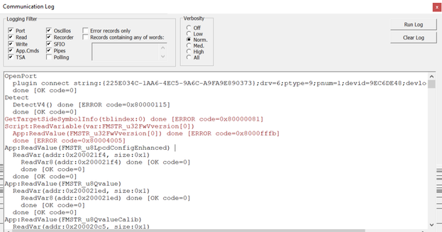

Hi @iulian_stan,
On this communication log you can see the error for the pcm.ReadVariable() function. And after that the successful variable reads for the variable watch.
On this one, you can see the same failed variable read and the successful one with the button, mentioned earlier.
49,220 Views
iulian_stan
Hi @nxf63246,
I was able to reproduce your issue - it happens only when the variable info is loaded from an ELF file (I was using TSA in my tests, but from your logs I noticed that in your case TSA call fails meaning it is not used).
Unfortunately I don't have a solution, we will further investigate this issue. As a workaround I could suggest:
  • Define your embedded variables in a TSA table (in your embedded project)
  • Implement a workaround in JS - either with an initial delay as you mentioned before or a retry mechanism
var retry = 3;
function read_variable(name)
  /* ReadVariable uses FreeMASTER variable object from current project. Use
   * ReadUIntVariable to access the memory directly using a symbol name. */
  pcm.ReadVariable(name)
    .then((response) => {
      $("#var_read_text").val("Variable value: " + response.data);
    .catch((err) => {
      if (retry--) {
        setTimeout(() => read_variable(name), 100);
      } else {
        retry = 3;
        on_error(err.msg);
I will post updates on this thread once we find the root cause of this issue.

MichalH
NXP Apps Support
NXP Apps Support
Hello nxf63246,
I confirm the issue in the FreeMASTER desktop application. The OnCommPortStateChanged(true)  and OnBoardDetected() events are triggered prematurely. Variables which are accessed within approximately 100ms after these events may return the 'port not open' error.
The reason why the issue appears only when using an ELF file but not with TSA is just a question of processing speed. The ELF file is read much faster than TSA.
The simplest fix is to delay the event handler execution:
pcm.OnBoardDetected = ()=>setTimeout(MyOnBoardDetectedHandler, 100);
pcm.OnCommPortStateChanged = (x)=>setTimeout(()=>MyOnCommPortStateChangedHandler(x), 100);
As the FreeMASTER 3.1.3 version is just being published, this issue will be fixed later, in a next version planned for Q1/2022. I can provide a hotfix version if you need it.
