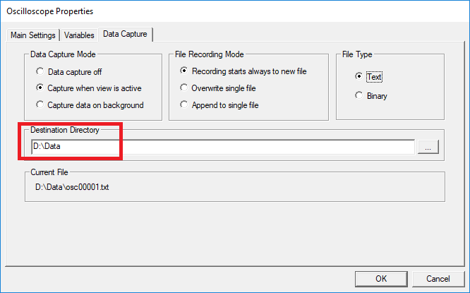

The function is all right except the data captrue.
I can't save the file.

Dear Charl,
when capturing data to file, FreeMASTER does not create directories automatically. Can you make sure the destination directory exists?
Michal

623619261
Thank you for your help,
   I solve it with your help.I was used to creating directories automatically .
