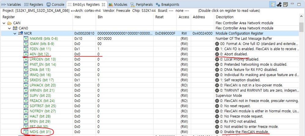

I guess these are SDK functions - you did not change them and just call CAN_Init in your custom code. Is that right ? (Just a tip - you don't need to share this code, a print screen of your configuration from ProcessorExpert and SDK version should provide all the info so I can reproduce it on my side).
Could you check MCR[AEN] flag after CAN initialization is done ?
If it's set to 1 you need to disable it as I mentioned in the other post.
 --> Yes, AEN resolves to zero.

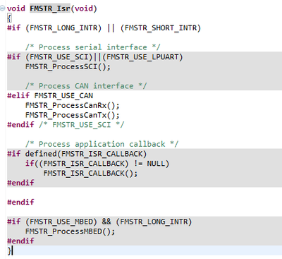

seyoung
Yes. I have set the CAN settings as shown in the figure below.
Interrupt method: It does not go to the ISR function.
Polling method: FMSTR_ProcessCanRx(), Tx() function is not executed.
