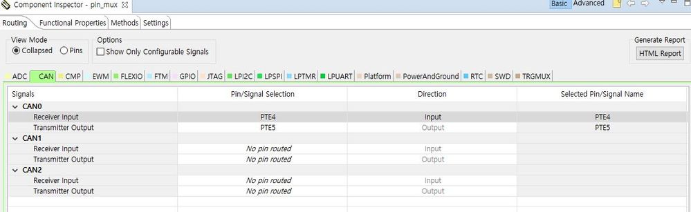

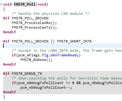

seyoung
Yes. I have set the CAN settings as shown in the figure below.
Interrupt method: It does not go to the ISR function.
Polling method: FMSTR_ProcessCanRx(), Tx() function is not executed.
12,687件の閲覧回数
seyoung
The pin mux settings are as follows.
