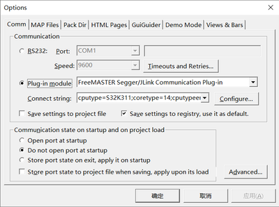

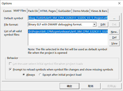

I'm using FreeMASTER to connect to a S32K311 board with Segger/JLink plug-in. However, when I start to communication (press Go button), my board stopped sending CAN messages, and the variable value in FreeMASTER I want to watch never changed. It seems the MCU stopped working.
My FreeMASTER configuration is as follow.
My FreeMASTER version is 3.2.6.3.

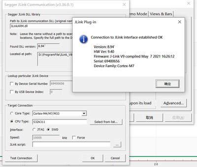

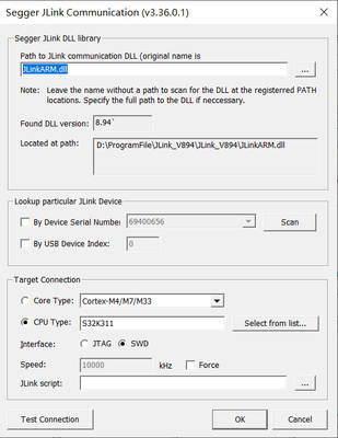

My JLink version is v8.94. And I also tried v 7.98.
My IDE, S32 Design Studio, version is V3.5.
I've tried the following solutions:
(1) Re-install FreeMASTER.
(2) Re-install JLink.
(3) Try other board with S32K342.
(4) Load JLinkARM.dll manually.
This question has been bothering me for many days. Can any body help me? Thanks a lot!
