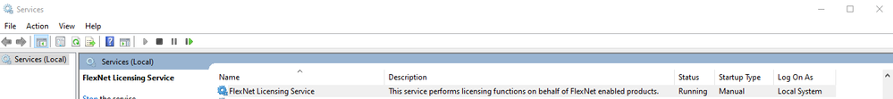

Dear Lulian,
I received the following error message while try to install the version 3.0.1. Can you please help me with this? thanks
best regards
Hi yangyangzhang,
Before troubleshooting this issue please note that activation is required by FreeMASTER Lite only. You can start by using FreeMASTER (main tool) by deselecting the second option in the component screen (first picture in the article above). This way you can skip license verification process.
Troubleshooting:
In most cases this one is related to user rights / group policies. Could you confirm that you have admin rights on the PC you are trying to install FreeMASTER on.
If so can you check the system services for the following item: FlexNet Licensing Service (it should be up and running)
Could you also provide your installation log, its default location is C:\NXP\FreeMASTER 3.0\_FreeMASTER_installation\Logs.
