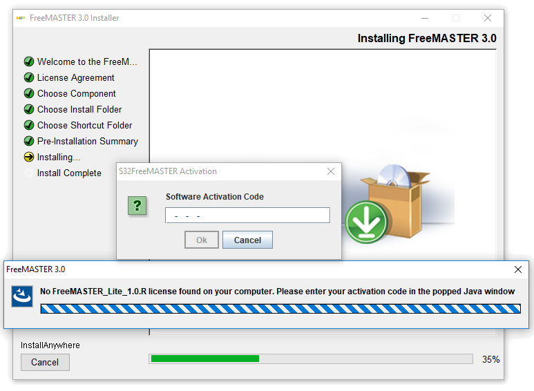

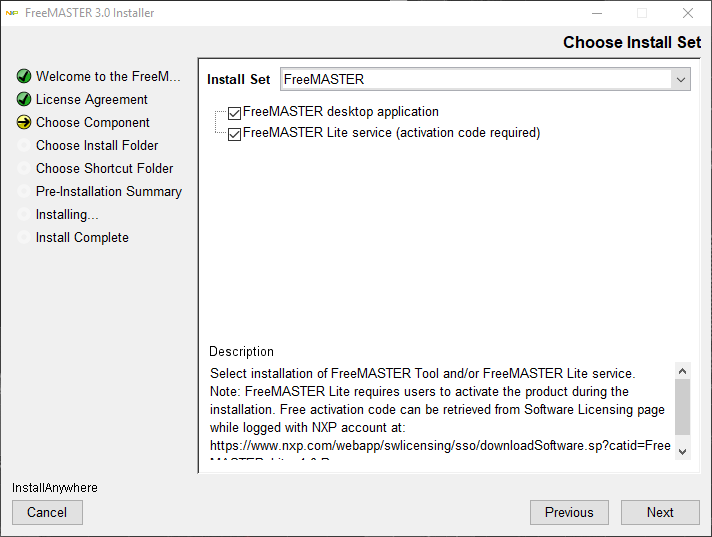

During the installation process you will be prompted with a Component Selection window (on Linux it has only one option - FreeMASTER Lite

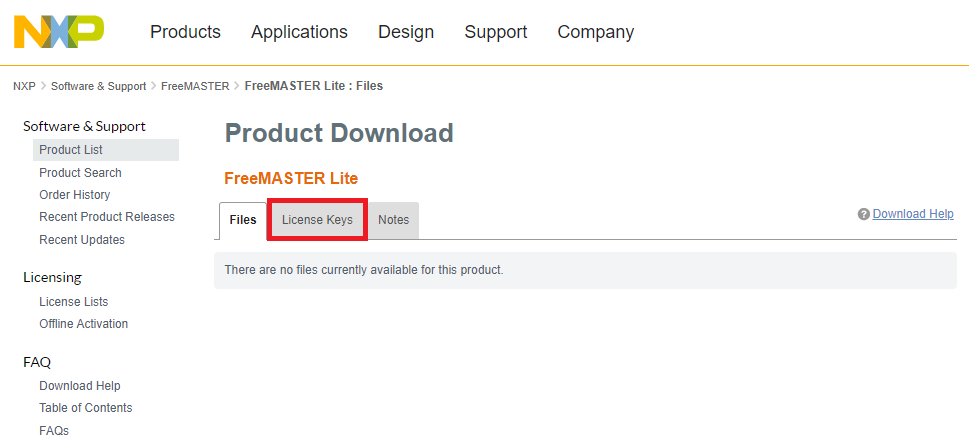

FreeMASTER Lite requires an activation code that you can get free of charge by following the link, also provided at the bottom of the window (see above).
Once you access that link you will also receive a email containing your activation code. It may take a while so you can continue with the browser option that will lead you to the product page.
The activation code is available inside License Keys tab. You will be required to provide the key during component installation.
After you input the activation the installation process will resume.

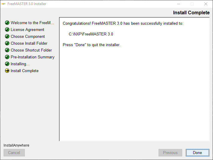

Now FreeMASTER 3.0 is successfully installed on your machine, inside your selected installation directory (is also displayed in the final window as above).

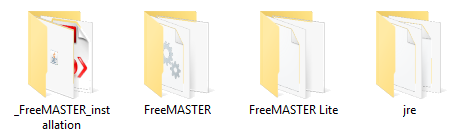

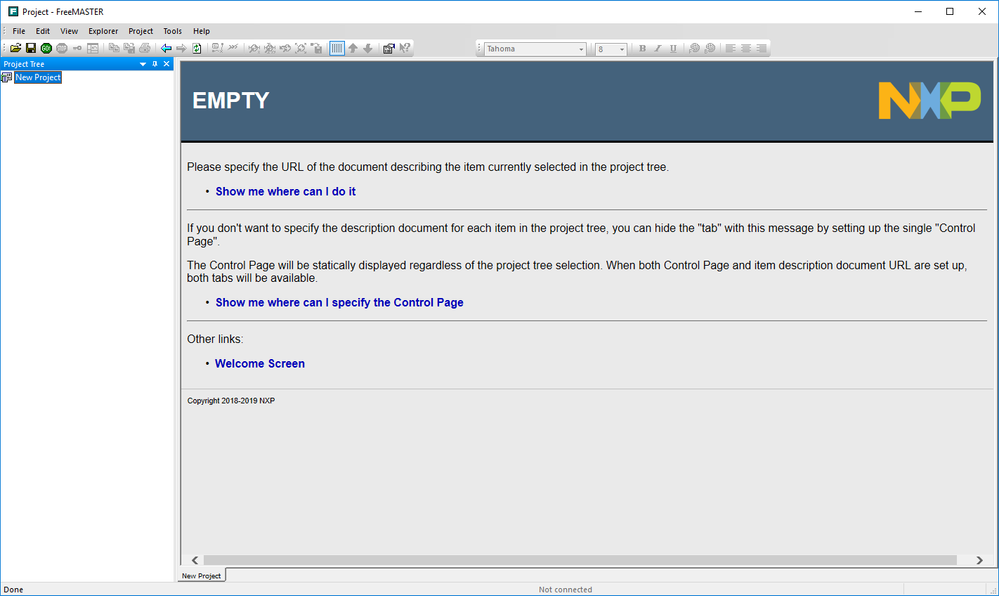

You can launch FreeMASTER & FreeMASTER Lite using created shortcuts or directly by running the executables from the installation folder:
  • FreeMASTER - FreeMASTER 3.0\FreeMASTER\pcmaster.exe
For more information access the User Guide by following the shortcut or directly from FreeMASTER 3.0\FreeMASTER\\doc\pcm_um.pdf

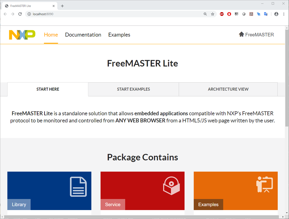

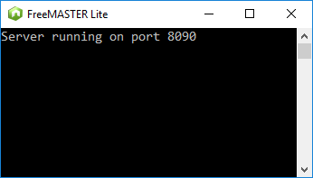

  • FreeMASTER Lite - FreeMASTER 3.0\FreeMASTER Lite\node.exe
It will automatically open the User Guide in system default web browser after you run the executable (if it does not open navigate to  http://localhost:8090/). It can also be accessed without running the tool by opening the FreeMASTER 3.0\FreeMASTER Lite\html\index.html file.

Dear Lulian,
I received the following error message while try to install the version 3.0.1. Can you please help me with this? thanks
best regards
Hi yangyangzhang,
Before troubleshooting this issue please note that activation is required by FreeMASTER Lite only. You can start by using FreeMASTER (main tool) by deselecting the second option in the component screen (first picture in the article above). This way you can skip license verification process.
Troubleshooting:
In most cases this one is related to user rights / group policies. Could you confirm that you have admin rights on the PC you are trying to install FreeMASTER on.
If so can you check the system services for the following item: FlexNet Licensing Service (it should be up and running)
Could you also provide your installation log, its default location is C:\NXP\FreeMASTER 3.0\_FreeMASTER_installation\Logs.
