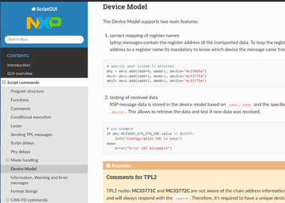

If you use the 665 as gateway, then you have to configure it prior using it, e.g.
you have to configure the ports: mapping of chains to ports, protocol version TPL2 or TPL3, timeouts, broadcasting...
Please check the MC33665A datasheet and phy_init().
Those lines are only relevant for correctly understanding response messages (mapping to device types). They do not impact the communication as such!
cmc1= devs.add(cadd=0, dadd=2, device="mc33772c")
cmc2= devs.add(cadd=0, dadd=3, device="mc33772c")
Further information can be found in the online help Device Model:

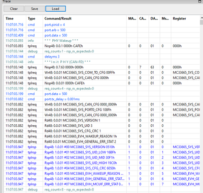

Q_man
From the information provided it's impossible to know whats going on!
This is the CANtrace you provided. I can not see how you startup the system!
06A2h -> PinID 4
65 6864.064 DT 06A2 Rx 6 01 11 90 01 61 70      Rsp48: 0.0.01 #06 MC33665_SYS_VERSION 0111h
66 6916.596 DT 0622 Rx 6 00 00 32 01 11 1B      Rd48: 0.0.01 MC33665_EVH_GENERAL_ERR_STAT 0
67 6916.797 DT 06A2 Rx 6 00 00 B2 01 71 43      Rsp48: 0.0.01 #07 MC33665_EVH_GENERAL_ERR_STAT 0000
68 6969.471 DT 0622 Rx 6 00 00 34 01 11 3F      Rd48: 0.0.01 MC33665_EVH_TPL0_ERR_STAT 0
69 6969.673 DT 06A2 Rx 6 00 04 B4 01 81 35      Rsp48: 0.0.01 #08 MC33665_EVH_TPL0_ERR_STAT 0004h
70 7022.266 DT 0622 Rx 6 00 00 33 01 11 15      Rd48: 0.0.01 MC33665_EVH_MCUIF_ERR_STAT 0
71 7022.466 DT 06A2 Rx 6 00 00 B3 01 91 3B      Rsp48: 0.0.01 #09 MC33665_EVH_MCUIF_ERR_STAT 0000h
72 7075.077 DT 0622 Rx 6 00 00 38 01 11 77      Rd48: 0.0.01 MC33665_EVH_ACC_ERR 0
73 7075.283 DT 06A2 Rx 6 00 00 B8 01 A1 84      Rsp48: 0.0.01 #10 MC33665_EVH_ACC_ERR 0000h
74 7127.782 DT 0622 Rx 6 00 00 30 02 15 AF      Rd48: 0.1.02 MC33772C_MEAS_ISENSE1 0
75 7180.216 DT 0622 Rx 6 00 00 32 02 15 B3      Rd48: 0.1.02 MC33772C_MEAS_STACK 0

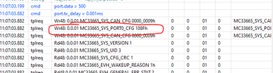

 As said ealier you first have to configure the 665 gateway device!
For example you FIRST need to configure the ports! The default configuration use TPL3 protocol, but you need to configure for TPL2 protocol. If you use Port #0 -> SYS_PORT0_CFG
Next would be to assign the CID  and to check if successful:
# schedule sync by cmd
Wr48: 0.0.01 MC33665_SCHED_CMD  1004h
Nop48: 0.1.63  00h CAFEh
Wr48: 0.0.01  MC33665_SCHED_CMD 0006h
Nop48: 0.{cadd}.63  01h CAFEh
# trigger sync
Wr48: 0.0.01 MC33665_SCHED_EVENT 0001h
Wr48: 0.0.01  MC33665_SCHED_CMD 0008h
# wait 0.75ms x num nodes
# assign
Wr48: 0.1.00  MC33772C_INIT 2
Wr48: 0.1.00  MC33772C_INIT 3
# check
Rd48: 0.1.02  MC33772C_INIT 1
Rd48: 0.1.03  MC33772C_INIT 1

did a global write with 0x11 instead of local write 0x10 for the CID/INIT register. Will update more once I get it completely working
16,683 Views
m_karthikeyan
Got it working, the
The PCAN-FD dongle I was using is the issue, I am not sure why, will try to reset or upgrade firmware, another newer PCAN-FD dongle sent the data and we got the reply from both 33665 and 33772's
