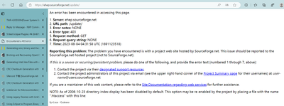

I tried to convert, but I couldn't get the following interface. 

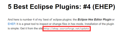

 In the process of learning, I first open the following web page:
When I was about to click on the link below to get the plugin, the page couldn't find it correctly.
So I don't know what to do next.
Looking forward to your response.

EHEP is a binary file viewer, you don't need that one to convert the file. I just used it to show binary files. And that link is not a web page link, but an Eclipse update site:
