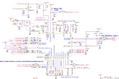

Greetings! We're trying to integrate the ADIN1100 phy into our custom baseboard. We use an i.MX93-based SoM running an Yocto-based linux , currently on kernel version 6.1.
I think we got at least some things right, as right now we're able to bring up the eth interface and connect the MAC to the PHY sucessfully, but there are never any TX or RX packets. I'll list below the steps we've been through to configure the device.
1) In the image below there is part of our schematics, regarding the eth phy.
The imx93 processor has FEC (fast ethernet controller) MACs ( ENET1). We're using the enet1 pins (I'll provide some part of the device tree below).
2) The ADIN1100 driver (which supports the ADIN1100 IC) https://github.com/analogdevicesinc/linux/blob/master/drivers/net/phy/adin1100.c
3) Enabled driver through CONFIG_ADIN1100_PHY, compiled successfully.
4) Related device tree nodes:

- ethtool -S eth0: everything is zero

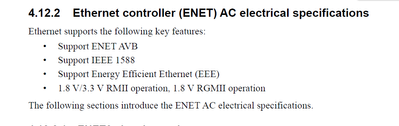

Current Vdd voltage is 1.8v and iMX93 support 1.8/3.3v right.
Right now we don't know what else to investigate. Please help me for further investigation.
Thank you
Akash

Hi Team,
ADIN1100 phy Vdd voltage is 1.8V and iMX93 host support both1.8V and 3.3V in RMII mode, hence in design we kept 1.8V as host iMX93 support, can you please confirm whether we can go with 1.8V in RMII operation?
Yaseen
