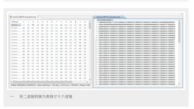

I am a student in another major and now during debugging, I need to convert the hexadecimal file to binary file format, but I tried it myself for a while and found that the conversion was not successful.
Now I attach the hexadecimal file.
If anyone can help me convert to binary file format, I would be very grateful.

This article
https://mcuoneclipse.com/2018/03/07/converting-binary-files-to-intel-hex-format-with-the-srecord-too...
shows conversion to hex and binary and back to hex again.

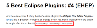

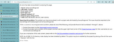

I tried to convert, but I couldn't get the following interface. 
 In the process of learning, I first open the following web page:
When I was about to click on the link below to get the plugin, the page couldn't find it correctly.
So I don't know what to do next.
Looking forward to your response.

EHEP is a binary file viewer, you don't need that one to convert the file. I just used it to show binary files. And that link is not a web page link, but an Eclipse update site:
