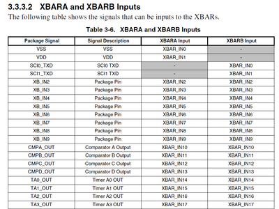

Hi, Terry,
I think you misunderstood it.
From crossbar hardware perspective, the ADC trigger signal A/B can select any signal from the Table 3-6. XBARA  Inputs, so logic_zero or logic_one are only option, but it does not mean that you can select logic_zero or logic_one to trigger ADC. You can select PWMx_TRG0 or TAx_out signals whatever, it is dependent on your application.

Hi, Terry,
Pls refer to the Table, the ADC  Trigger A/B signal must be selected from the following table, if you select the XBAR_IN0, it is VSS, it is logic_zero. If you select the XBAR_IN1, it is VDD, it is logic_1. If you select XBAR_IN2, the ADC trigger signal will be from external pad called XB_IN2.
Hope it can help you
XiangJun Rong

terrybogard
hi rongjun,
could you pls answer again about how the adc trigger will happen if the logic zero or one is chosen. your previous answer was about how to configure the trigger input to logic zero or one, which is not my wanted answer. such as if logic zero is chosen, adc will never be triggered, or adc will be triggered for all the time if logic one is chosen.
thanks.

terrybogard
thanks for xiangjun's explain with patience. so it seems make no sense to set the trigger input connect with logic zero or one, and I suggest NXP cancel these two items in menu to avoid misunderstanding.
