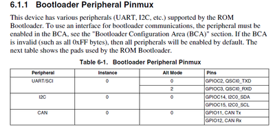

xiangjun_rong
Hi, Stephen,
Regarding your question, pls refer to Chapter 6 ROM Bootloader in MC56F83xxxRM.pdf, I copy it here:
From the screenshot, you can see that the boot ROM of MC56F83xxx supports uart, CAN interface.
pls refer to the Bootloader-utility-for-MC56F83xxx, it describes how to download application code to MC56F83789 via blhost tools and uart interface.
https://community.nxp.com/t5/Digital-Signal-Controllers/Bootloader-utility-for-MC56F83xxx/ta-p/11032...
Regarding the CAN interface, it is said it is okay to use blhost tools to download code via CAN bus, but I never have a test.
Hope it can help you
