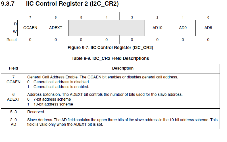

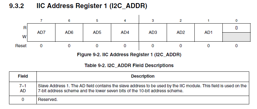

I am trying to figure the factory default slave address of I2C on MC56F8006.
I have a custom board with MC56F8006 and I would like to exercise I2C.
I read the documentation and I see the base address of I2C is 0x20.
I have some doubt but is this address the slave address of I2C when an external master wants to access it?
Can someone help please?

Hi, Theodore,
The MC56F8006 is a processor, if you set the I2C of MC56F8006 as slave IIC module, the slave address of IIC module is programmable, the IIC address register1 is the slave address.
In 7 bits slave address mode, the I2C ADDR register is the slave address:
If you use 10 bits slave address, you have to write another register I2C_CR2:
