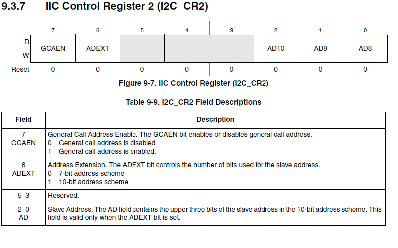

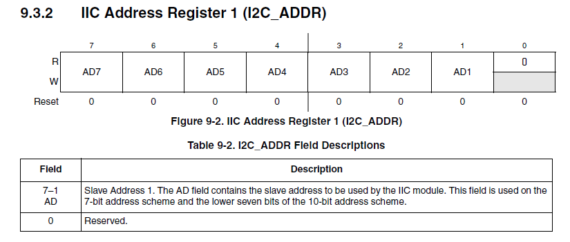

The MC56F8006 is a processor, if you set the I2C of MC56F8006 as slave IIC module, the slave address of IIC module is programmable, the IIC address register1 is the slave address.
In 7 bits slave address mode, the I2C ADDR register is the slave address:
If you use 10 bits slave address, you have to write another register I2C_CR2:
