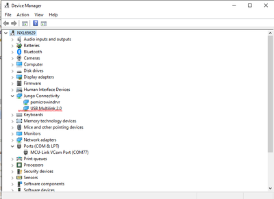

while Iam trying to debug in CodeWarrior IDE using Multilink LC debug probe, getting the below error
please get me solution to resolve this.

xiangjun_rong
Do you use CodeWarrior for MCU ver11.x tools and Multilink Universal device? what is the part number you are using?
Pay attention to the pin 1 of the 14 pins JTAG connector, the red line of flat cable is cable 1.

Ujwala_kontham
Yes, Iam CodeWarrior for MCU ver11.x tools and am using Multilink Universal REV E (PEM9D3DA6) debugger and MC56F82746 uc and did correct connection as mentioned

xiangjun_rong
if you insert USB port, can you see the USB icon on the PC device manager?
I have tried to connect the multilink Universal with MC56F83000-EVK, no problem.
This is the device manager of PC

xiangjun_rong
On the Multilink Universal device, you have to connect the 14 pin PORT A JTAG/ONCE connector.
