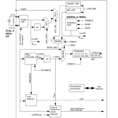

xiangjun_rong
Unfortunately, the MC56F827xx does not have a block diagram for the clock.
I copied a block diagram from MC56F825x, but the PLL output clock frequency is not the same.
When you use PLL, you have to switch the MSTR_OSC clock, then configure PLL so that it can output 200MHz, and check if it is locked. After it is locked, switch to Fpll/2 clock source.
Hope it can help you
XiangJun Rong
